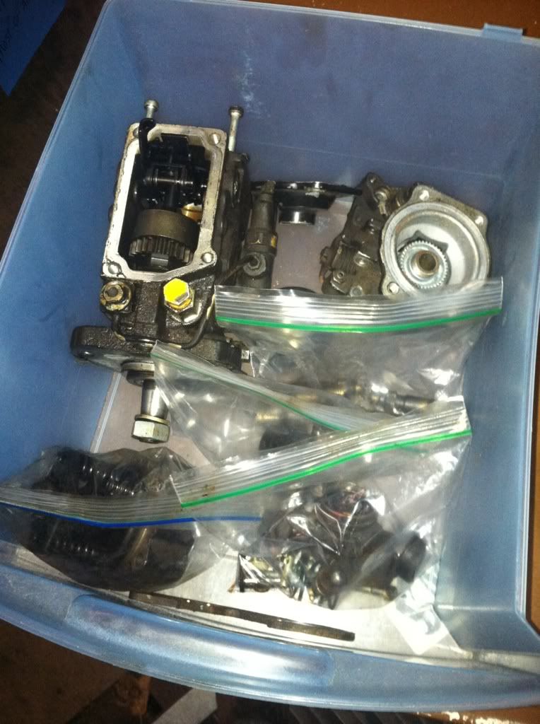

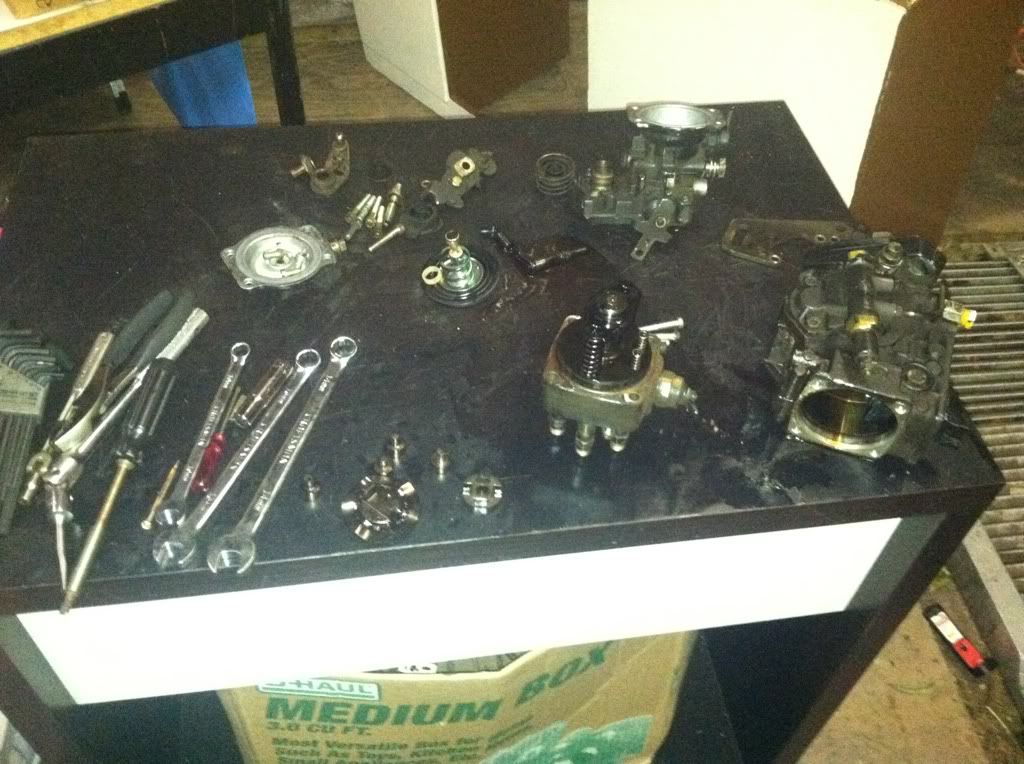

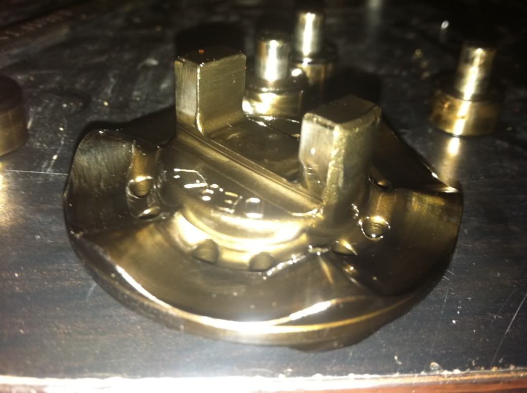

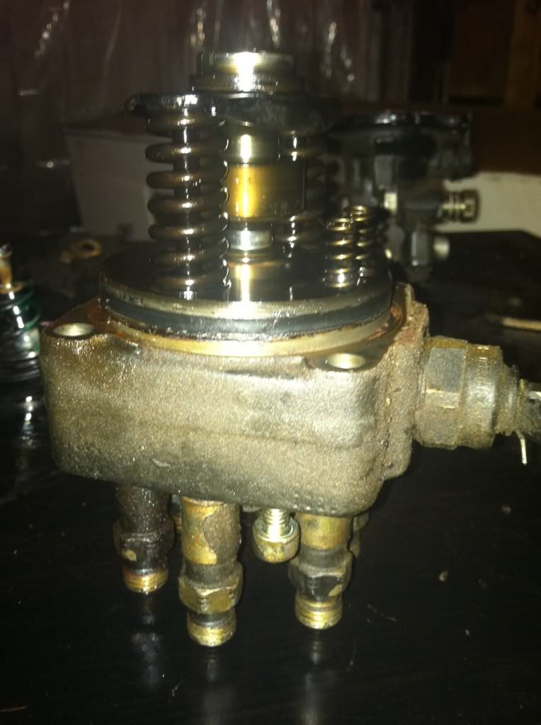

I started by just pulling the top off my spare pump to do a re- seal and 354 spring, then saw what it looks like when a pump is run for 120K miles with red diesel and an owner who dosnt change his fuel filters.
the inside of this pump was stained black, so I'm going to pull it apart and try to do a home-grown rebuild.

so far...

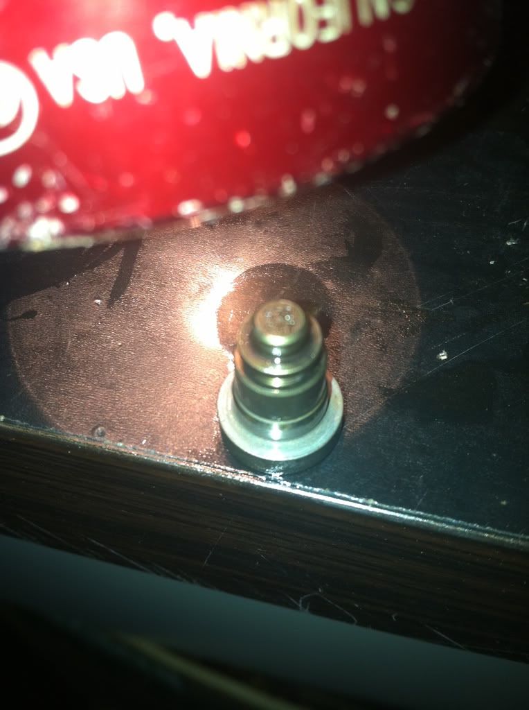

a DV..
didnt get the #'s off it yet, hoping to maybe replace them with something a little better
lots of small parts!
