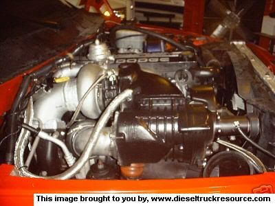

Postby BC847 » Sun Mar 30, 2008 12:36 pm
Here's what appears to be a set of turbos with a Whipple supercharger between the two.
Odd IMO. Bear in mind a Whipple is not a positive displacement compressor as the Roots. It's belt driven turbine type compressor. Sorta a combination of both advantages of the multistage turbocharger (perhaps less super-heating) and blower (direct drive). :)
Postby cummins king » Sun Mar 30, 2008 1:43 pm
i bet they spent a pretty penie on that
