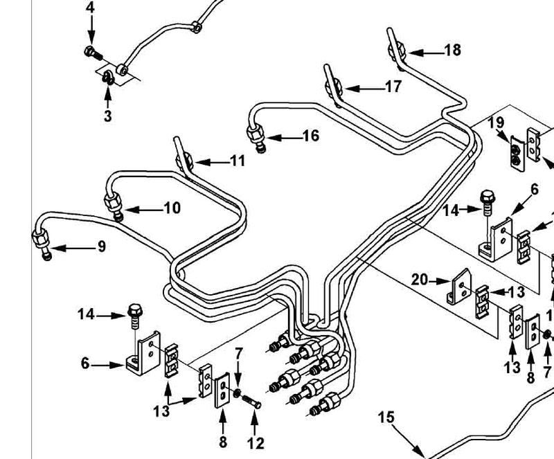

Postby Begle1 » Tue Oct 28, 2008 12:03 am
CaptainChrysler wrote:Factory water to air aftercooler injector lines would probably work.
I've never seen them.
What do those injector lines look line?
Begle1
Posts: 1968
Location: Kihei, Maui, Hawaii
Postby CaptainChrysler » Tue Oct 28, 2008 10:12 am
like this:
1993 W-350 EXT CAB SRW
GETRAG, DC-1'S, 285'S
370'S, HX40, 5" EXHAUST, BHAF
1989 W-350 SRW
GETRAG/NV273
P-PUMPED, 2.6" S400
WATER-2-AIR IC, SBC DD
CaptainChrysler
Posts: 49
Joined: Tue Jul 29, 2008 2:20 pm
Postby Begle1 » Wed Oct 29, 2008 12:34 am
Ohh yess... That looks like it would be a step in the right direction.
How much do you think those lines would cost? :shock:
Judging by the spacing on the injectors, it looks like it'd let you have a nearly two-foot spread instead of the stock two-inch spread.
