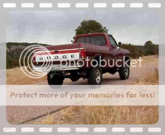

Postby Ezra » Sat Nov 29, 2008 5:58 pm
Image Not sure why posi didnt work...
93 W250,auto,3.54's..167k miles..asa modified intake.stans 4in,.industrial injection pump.6x.016's..S300 62/71/14..piston lift pump..And still more to come.

Postby Richie O » Sat Nov 29, 2008 6:07 pm
My posi is real good that way. I have never had that happen. It sure acted like a open diff. Maybe you came on it to softly to get the clutches to grab.
Postby dragrdan » Sun Nov 30, 2008 2:53 am
If it was easier to overcome the posi's resistance than it was to over come the drivers rear brake it will do that. Notice the drivers tire started spinning when the brake was released.

Postby DTanklage » Sun Nov 30, 2008 11:51 am
dragrdan wrote:Notice the drivers tire started spinning when the brake was released.
it did?
how did you see that thru all the smoke?
lol
how many miles have you driven since adding some super secret posi juice?
you have to add a bottle of that stuff every 10-15k or the posi will start slippin. once it starts slippin it dont take long to burn the clutches out of it. once the clutches are burnt out of it you get exactly what you saw in the video

Postby dpuckett » Sun Nov 30, 2008 3:22 pm
Maybe your rear brakes arent adjusted evenly?
All the Dana70 posis I've had in the past would turn into a spool when the clutches wore out. The only thing I can think of would be that you somehow got too much friction modifier in there (3 bottles?), or the left brake was holding more than the right.

Postby DTanklage » Mon Dec 01, 2008 2:51 am
dpuckett wrote:All the Dana70 posis I've had in the past would turn into a spool when the clutches wore out.
Daniel
how could a limited slip unit do that dan?
plz explain

Postby dpuckett » Mon Dec 01, 2008 8:36 am
The clutches in the carrier lock up, and then both sides spin at the same speed, not allowing for cornering. Very simple to see if one has ever had the carrier apart.
Had it happen on me with a loaded trailer coming from Estes Park to Loveland CO one afternoon. Popped and lurched around every curve.

Postby DTanklage » Mon Dec 01, 2008 7:32 pm
DP
and if you had it apart and forgot to put the clutches back in it will work like a spool?
i dont think so...

Postby dpuckett » Mon Dec 01, 2008 9:10 pm
No, you didnt smell what I was stepping in.
The clutches are supposed to slip some around corners, and grab when the difference between the sides passes a certain amount. Now, you wear the clutches down, removing the slip, and you get a spool. This happens in the course of normal wear/ too little friction modifier, everything still assmbled. Like what happened in my first CTD, and the last auto I had last spring (though I recogninzed the symptoms much earlier, and had to replace only the clutches and bearings- no gear damage).
The part about taking it apart was IF you have taken one apart, you'd see what I was talking about. The Dodge D70s are the only diffs I have experience with, so excuse my ignorance of "normal" limited slip operations, if they are different from the Dodge versions.

Postby DTanklage » Mon Dec 01, 2008 11:56 pm
so you are saying the clutches that allow slippage around a corner are not the same clutches that lock it up when you are trying to do a burnout?
how many clutch packs were in the carrier you took apart?
lol
i have not had one apart
the ring gear still spins the carrier right?
what makes the axles turn?
not the clutches?????????
only reason i am still arguing is cuz i have had lots of other models apart
and cuz i have a little bit of common sense
make it a great night!

Postby dpuckett » Tue Dec 02, 2008 8:54 am
The clutches that allow minor slip around corners ARE the same ones that lock up when one wheel slips. Apparently the D70s are different from the others. I believe there are 3 clutches and 4 friction plates in each side of the carrier, outboard of the side gears.

Postby KTA » Tue Dec 02, 2008 9:11 am
The clutches work off the coefeccient of friction. If the linings are worn off and they go to steel on steel they start to chew each other up. That RAISES the coeffecient of friction therby making it harder for the spider gears to turn opposite of each other. That is why a worn out Dana can become grabby and lock up harder than a freshly rebuilt one. 8) I hope that explanation helps.

Postby DTanklage » Tue Dec 02, 2008 11:31 am
that did help...
so, why did dudes truck look like a peg leg????????

Postby KTA » Tue Dec 02, 2008 2:01 pm
Maybe it is an open diff?? Anyone checked to see whats in there or at least looked at the Build sheet, or is it just "assumed" to be a track-lock.
