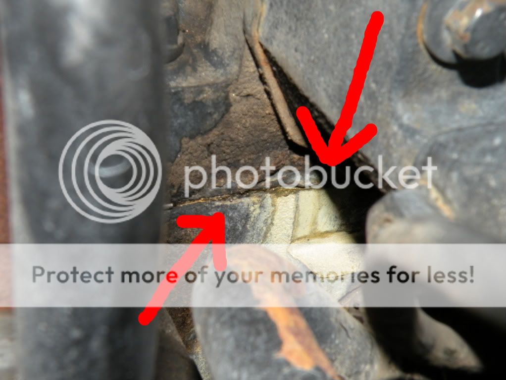

Postby Ezra » Wed Dec 24, 2008 5:21 pm
Image Well after i drove it today this is what it looks like.How bad is it? there is still no oil/coolant mixture.Ezra

Postby PToombs » Wed Dec 24, 2008 6:48 pm
Yup, that's the spot. Alot of these trucks seep there. You won't get any in the oil from there, it's just an external leak. Some guys go and get the head milled and replace the gasket, and 2 years later it starts seeping again.
Just get a torque wrench, set it to 125 ft lbs, and hit the bolts near the corner. I did mine with a breaker bar a little, and it was enough to get it to stop.
Postby Ezra » Wed Dec 24, 2008 7:38 pm
I think you saved my christmas Pete.lol.I got take my truck 1300 miles home ,the day after christmas.So I need the truck.So you dont think I should be worried about it?
