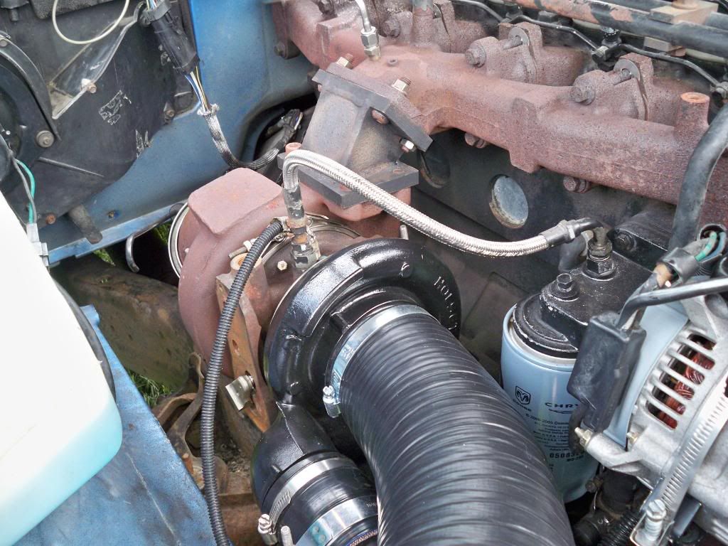

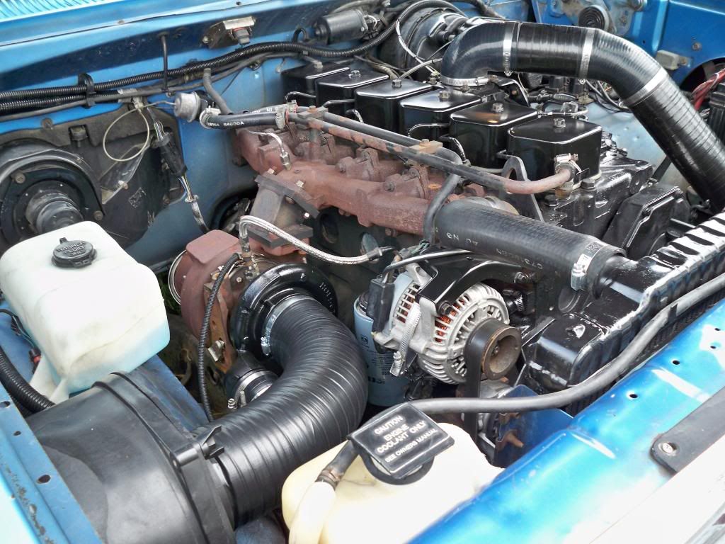

Postby c12h26 » Sun Aug 30, 2009 5:10 pm
I put one on my truck and I like it,I have not came up with a way to control the vanes yet so it is in the full open position all the time,it spools a little slow but when it lights it pulls hard
here are some pics

Postby burnt_servo » Mon Aug 31, 2009 11:29 am
c12h26 ;
how slow is the spool up ? do you have something you can compare it too ? ( like maybe the stock turbo / stock housing ) .
i've got one of those turbo's too , i was thinking of limiting the movement of the vanes so it wouldn't close down too tight ( to keep the turbo from overspooling ) , then using something like a regular waste gate actuator to move the lever .... ( i'm thinking of something much much larger in diameter than a regular waste gate actuator , so it will be much more sensitve to pressure changes )
then maybe add a external waste gate that would kill the exhaust pressure at lets say 40 psi

Postby TRENDZ » Mon Aug 31, 2009 6:23 pm
I also am planning installing one of these turbos. I see you have the actuator exposed, and no coolant running through it. Have you manually moved the lever with the engine running? What were the results? How does the turbo sound?
I was also considering a back pressure based control with a manually adjusted travel limiter. If anyone gets one/has one of these working with some control, please post! I have one, but the truck is so far apart right now that it will be months before I get to try it.
The compressor wheel in this turbo looks real nice, Im sure it is capable of some good power.
