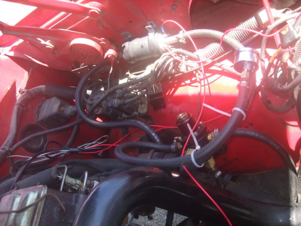

Re: Walbro and boost ref regulator
Postby Ace » Fri Nov 05, 2010 3:12 pm
oldestuff, don't take this wrong, just an observation, but I don't think I like your plumbing! :sad: Looks like you've got the pump output running through rubber line all around the electrics on your inner fender. Please tell me that is high pressure tubing and "NOT" worm gear clamps on a hose barb coming out the high pressure side of that pump.
Just sayin'....
