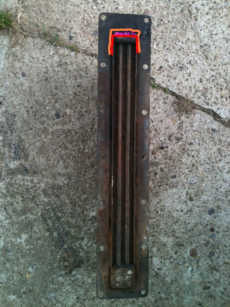

If I ever make it home at a decent hour I'll bust out the MS Paint and show you what was up. I welded it and it's working fine now.

Here's the middlecooler explanation pic for you girls. Orange is flange sealing surface and red is the edge of the core. The little dots of Pete's favorite color are somewhat covering up the sidewalk concrete you can see through that gaping hole.

Well, that makes sense that it's a leak to the outside, I just couldn't see that in the original pic. I even went back and looked at it again and to me it looks like some white spots on it. I'm just glad you got it fixed so we can go back to the regular non truck nonsense we talk about. :lol:
