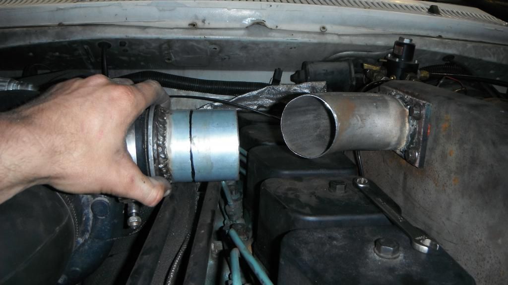

Postby Tacoclaw » Sat Dec 01, 2012 12:08 pm

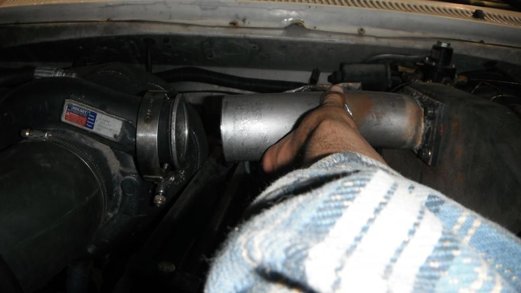

New crossover is almost done, I've just got to get an actual welder over there to finish it for me. I almost did it myself again, but I remembered this will be the first thing everyone sees when they open the hood so I resisted. I'll put pics of the one I made to show you why after I get this one on here.

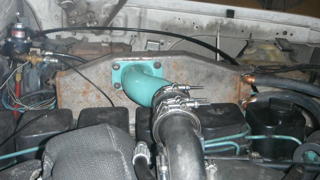

Just noticed I had the turbo-side section turned backwards in this pic. There's just enough flat area on it to get a coupler and clamp on it. It's pretty cool setup like this because there's literally nowhere for the boot to go. I don't think I'll need to put beads on it or anything to hold it. :grin:

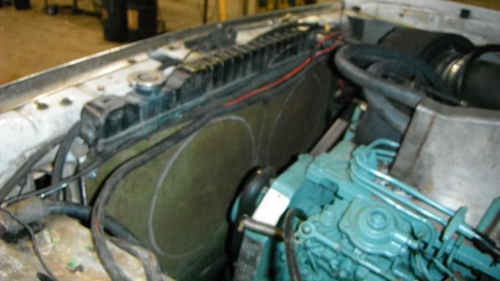

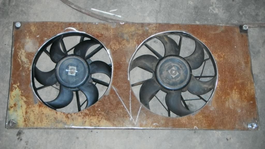

Yet another busy day. My welder didn't show up again so I decided to tackle a couple of my truck's more glaring problems.

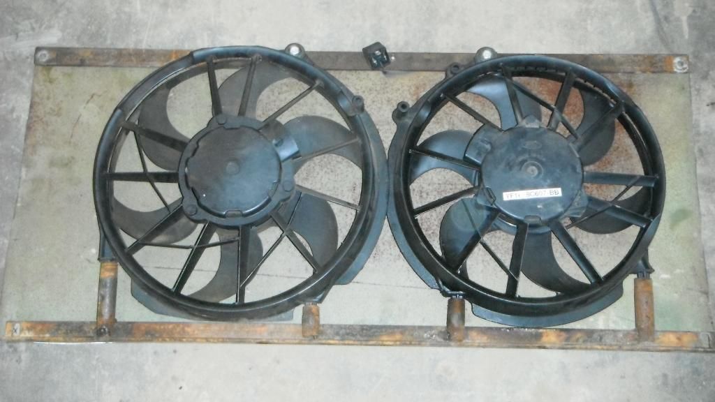

First of all, my truck and I haven't been able to come to an agreement on when she should warm up in the mornings. I say it's before we leave the driveway. it says right before we pull into work. We never had this problem until I put those electric fans in and set one to key-on, but that's how it will be until my controller gets here. Instead, I set about making a shroud to block off the radiator a bit.
My epically-ghetto fan mounts in case anyone forgot what they look like. :lol:
As of right now, I've got the shroud sitting right against the core, so the fan can only pull through it's little hole and the air can't push through once I'm moving. Once I get things together a bit I'll space it out from the core and make it so the fan is pulling through the entire core.

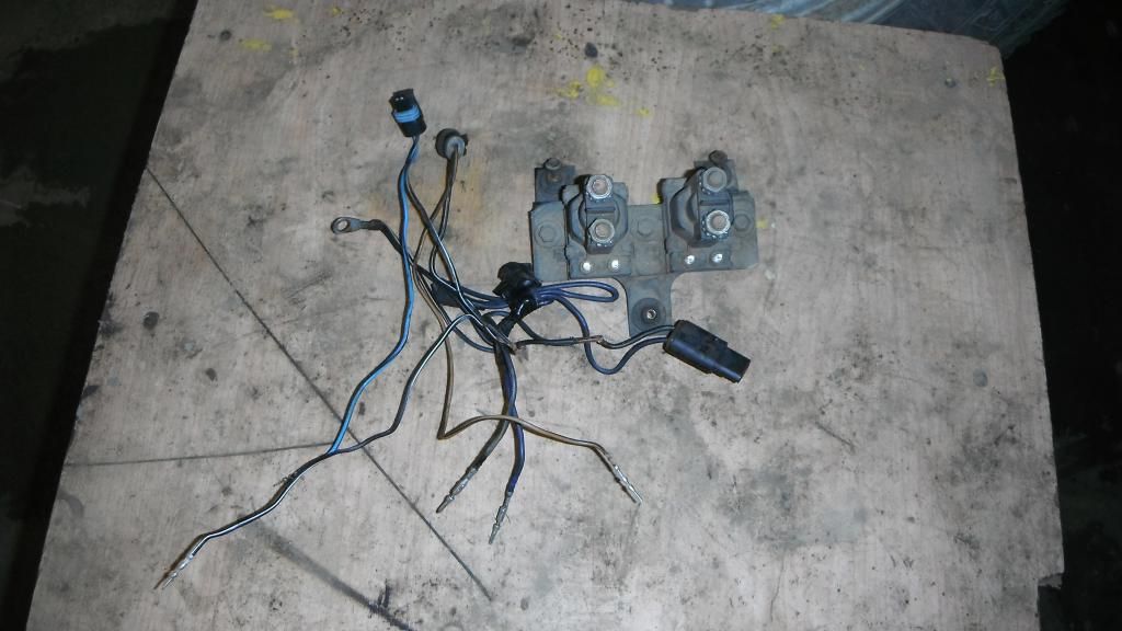

I also trimmed some fat in the underhood harness and got rid of all the WIF, fuel heater, intake temp, and anything hooked to them. I'm still searching for the resistor that's supposed to be inline of the KSB, but until I find it I just moved the KSB's pin over to the spot that used to be key-on for the fuel heater. I tried to use just the smaller, 4-pin connector there, but the KSB has a fat pin on it's wire so it wouldn't fit in there. Oh well.
Also a funny story, for some odd reason my truck's speedo refuses to work if the coil wires are unplugged off those grid relays. I have no idea why yet, but this is the second time it's happened.

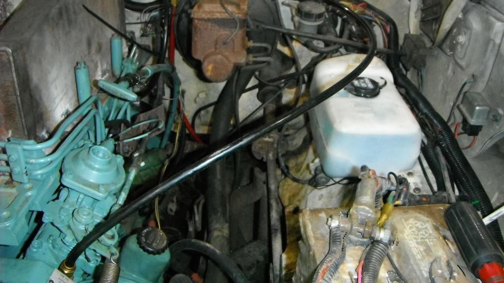

Finally, I threw in the washer fluid reservoir I bought off Mark a million years ago. I had to bring the washer fluid connector back through the harness to get it over to the drivers side, but aside from the usual hidden bare hots this truck always seems to have it was a breeze. I'm only using the driver's washer right now since the "T" broke off on the one I left flopping under the hood for the past year, but once I get another one I'll reverse the hoses and have them both spraying again.

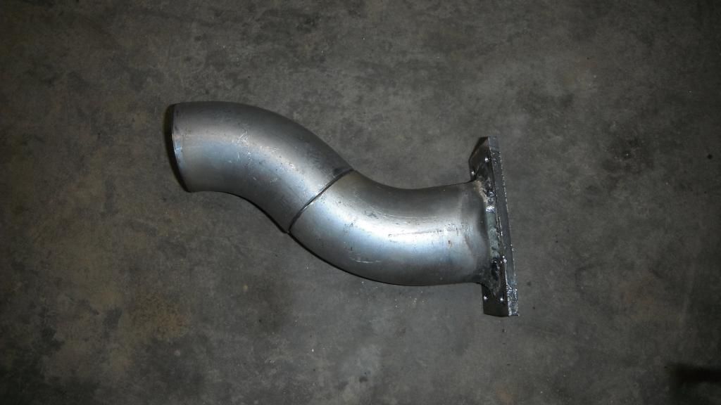

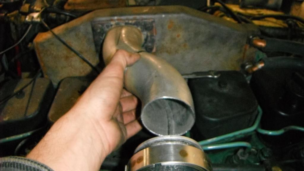

Postby Tacoclaw » Mon Dec 03, 2012 4:46 pm
DodgeFreak wrote:
Tacoclaw wrote:The leaf spring acts almost like a bar, that's why leaf-sprung vehicles don't need any other locating links. The front spring eye on the rear axle acts as a pivot point. If you drop the rear of the spring down 4+" it will swing your axle in an arc.
I'm not sure how noticeable it will be by only deleting my block and not lifting it or anything but I'm going to assume it will be enough to bother me. I haven't even dug into the measurements of me making my own shackle flip but I may get around to it tomorrow.
Or not, that's y beer-drinking time. :mrgreen:
Unless you drop the front with the rear....
Seriously though, I'm already past my personal allowable lift limit by an inch, dropping the front will make it even worse.

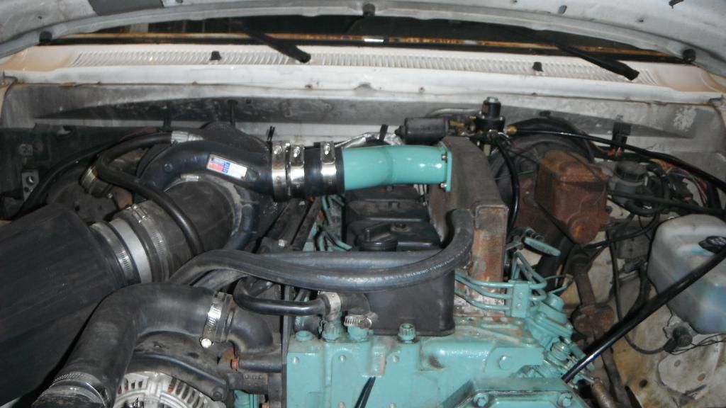

Here's the new crossover in all it's glory. I may clean some more edges and have some more weld thrown on so I can smooth out the seams some more, but this it it. I painted it just for Pete, the middlecooler will be black. I may pop the compressor housing off this turbo and paint it DD green to see what I;m in for. :D
