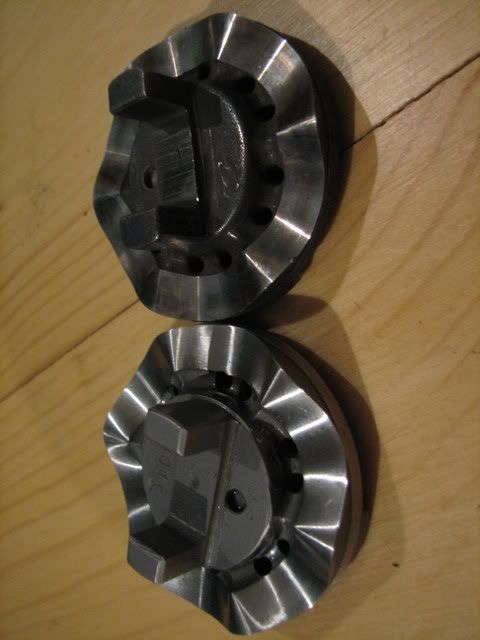

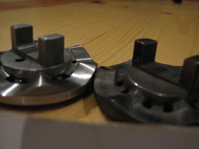

Postby cummins king » Tue Apr 29, 2008 7:02 pm
left side 4mm, and right side 3.4mm
93 4X4 auto
cummins king
Posts: 1741
Postby seeker1056 » Tue Apr 29, 2008 7:16 pm
nice lookipiece - how much did you say they are now that they are made?

Postby cummins king » Wed Apr 30, 2008 4:30 am
they want 350.00 for them but since i bought a bunch of stuff from them and two cam plates they gave it to me for 300.00 plus 20 shipping
and after i purchased them they sent me an email saying thy didnt thing it would be a good idea to run the 4mm with the 14mm head, haha

Postby Begle1 » Wed Apr 30, 2008 9:00 am
big specht wrote:Why I think that would all go together good more lift and a bigger head ?????
The greater lift with the bigger head is just going to beat itself apart at RPM...

Postby 75Dodge » Wed Apr 30, 2008 11:21 am
CK that rotor is AWESOME! but can the internal springs take that much more compression? WHat if you put in stiffer springs in the head? Has anybody tried that? I have a pump here, off-highway, that has stiffer, but smaller, springs than my pump. You think that would increase output pressure to the injectors?
