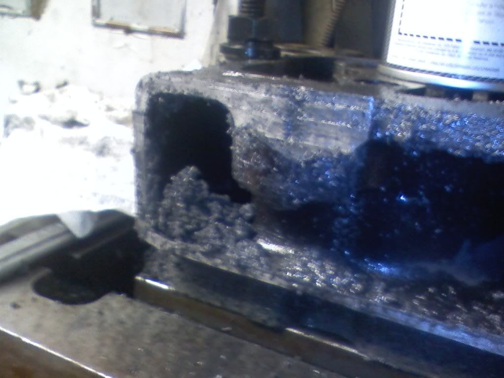

honestly, I dont believe that modifying an intake plate does that much good, I can see a larger inlet doing good things for you but #1 and #6 need more than just a bit of diverted air to keep them happy
this^^^ is the bump that #1 needs to fight against, pluss that runner is directed away from airflow, airt needs to go up, around and make its way into the runner wich not only affects volume and pressure, but changes how the air enters the valve bowl....lots of badness IMO

Ahale2772- That's the kind of info that means something to me, thanks. I can't do anything about that bump without gitting rid of the intake log, correct? So that is why there is a marginal gain with a twin intake. It makes sense! I hadn't seen inside a head before. My non-IC'd intake plate has the hole towards the front IIRC. I'd need an IC'd one that has the hole in the center or i could go fancy and make a twin intake plate, either way i would need a new one or i would have crazy angles in my IC tubes

yeah, not much you can do about that bump with the head on the truck, If it was off you could definently die grind it down and stick a small bolt in it to plug it, you can just barely see threads in the center of that bump, it simply a casting mark for some mount hole
