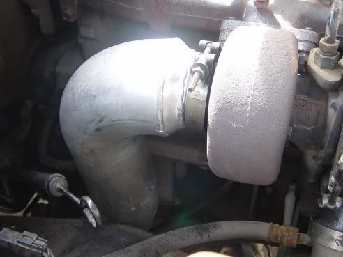

Postby Philip » Sun Feb 24, 2008 12:05 pm
Michael I went out and did some measuring for you. The down pipe I have can be cut down for the HX40 with out any problems. On the pic I am posting the cut line will be 1" back past where the 4" to 3" reducer is welded on.
The housing I have on the HX40 is a WG'd 16cm.
