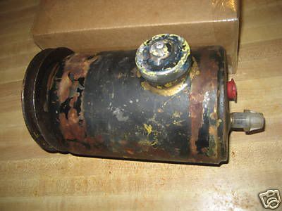

Postby Begle1 » Mon Apr 07, 2008 8:40 am
The cheapest 12 volt "power pack" that I see in their catalog costs $399, but flows 2.3 GPH at 2,500 PSI. Like, way overkill.
Maybe I should be looking at 12 volt pressure washers for something more economical.
BUT, they also have electric clutches for pulley pumps. That how snow plow guys do it? Sounds to me like I gotta find an electric clutch of eBay.
Begle1
Posts: 1968
Location: Kihei, Maui, Hawaii
Postby Begle1 » Mon Apr 07, 2008 8:43 am
Here's a unit that screams like it wants to be used.
http://cgi.ebay.com/12V-Hydraulic-Clutc ... dZViewItem
Still way overkill though... But when it's cheaper than a Harbor Freight powerwasher who cares?
Begle1
