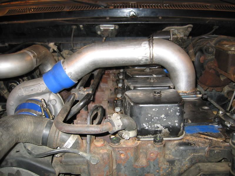

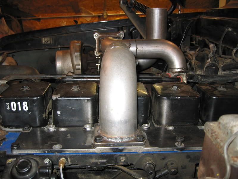

Postby CaptainChrysler » Tue Nov 25, 2008 8:41 pm
CaptainChrysler wrote:I am building a 3" one right now. Will have pics when the compressor cover gets here.
Better late than never. Here is how it turned out.
3" 90* (3-1/2 radius) elbow
3" 30* (3-1/2 radius elbow
The elbows were $17 a piece and the boot was $15.
Made the plate for free. :D

Postby RSWORDS » Wed Nov 26, 2008 2:44 pm
What you going to do with the bracket for the throttle linkage?
I made some spacers to sit on top my plate to put the braket back up at the stock location.

Postby CaptainChrysler » Wed Nov 26, 2008 7:56 pm
I am going to do something different. I did not like how big it was for what it does. It's a 5 spd. w/o cruise.
