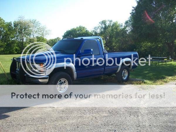

Still waiting on a call back from the pulley cats, I threw on that set of Chevy wheels I bought a while ago just to see what they're like.
Meh, I think I'm going to start the hunt for a set of 3rdgen wheels. I just can't find any aftermarket wheels that I actually like and wouldn't hate to clean. Also, photographic proof of how pathetic and dirty my truck is anymore. I got to working on the RC swap and have just completely stopped caring about how it looks. :lol:

Postby Tacoclaw » Fri May 17, 2013 5:26 pm
Those wheels are an odd thing, sometimes I look at them and completely love them, like that pic, other times I see them and just hate them. The backspacing is hella bad on them, but it'll be the same on the 3rdgen wheels. I'm probably going to get different-sized spacers to try to get the rear tires out a little farther.
I can't hate on those Chevy wheels yet though, nothing bad has happened since they went on there. ...yet.
