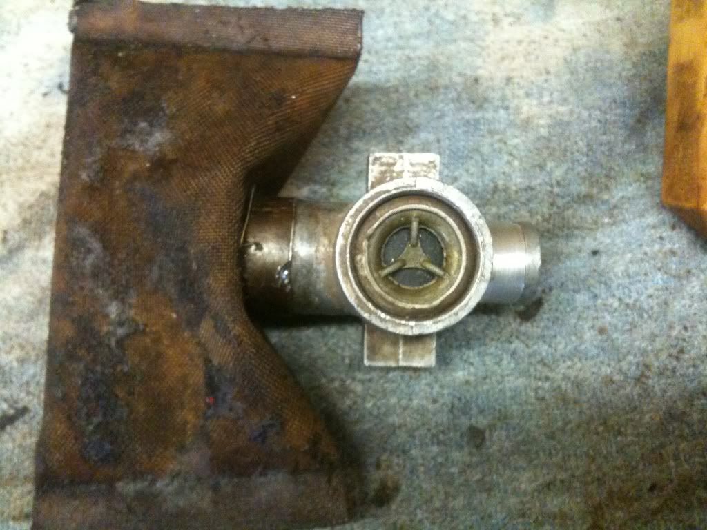

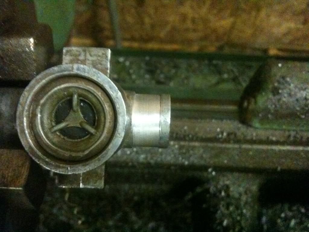

Well, here's the plan:
This ends up being about .620 at the "barb". I could either try to stretch 1/2" over it or clamp 5/8" down on it. Considering how much an air leak would suck there I'm going to go out of my way to get 1/2" to stretch. I drilled it out to 15/32", so so far it's got a .040" restriction from 1/2". I'm making my own bulkhead fitting so I can keep it at 1/2" through there too. I plan on using the truck air brake line once I'm out of the tank, but it's not flexible and there's no easy way to attach it to my valve. I though about heating it and melting it on there, but that stuff just isn't the same once it's been heated that hot...

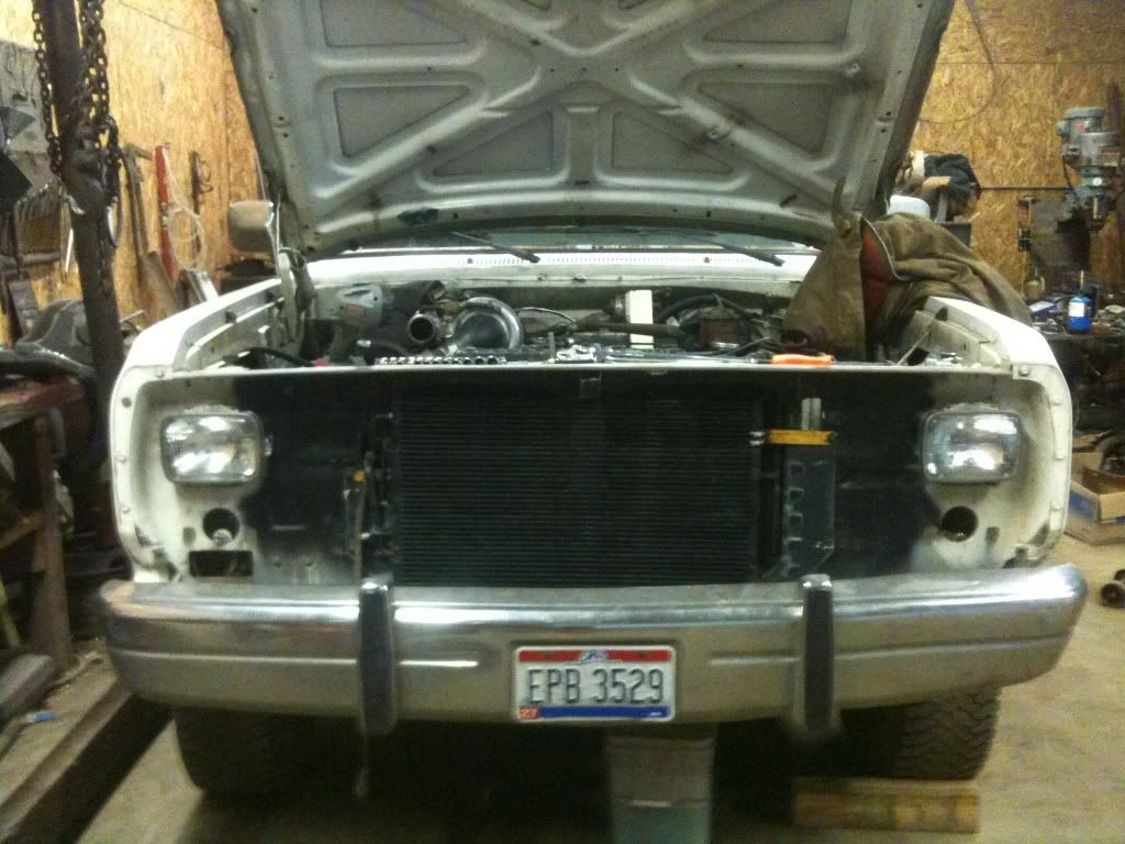

I'm also going to go out of my way to find one of those Ford Taurus electric fans. Look how much room there is here once that fan is gone.
Also, please keep your grills on your trucks, they're ugly as sin without them.

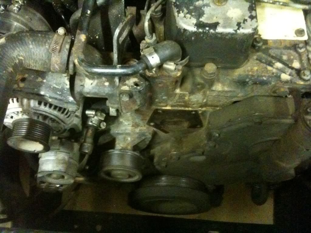

Postby Tacoclaw » Tue Jan 03, 2012 5:48 pm
Still can't decide on the pickup, I may just ditch all that crap and run an inline screen. I'm still searching for flexible line, that stuff he told me to get turned out to be semi rigid, almost like truck air line. I've got time, so I'll keep looking.
Anyways, [Austin Powers] I've lost my Mojo, baby![/Austin Powers]

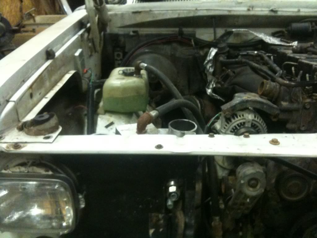

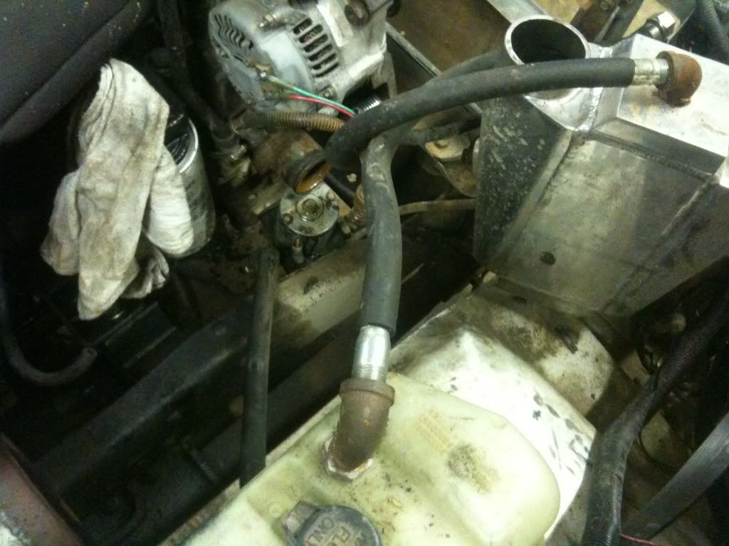

And here's the air to water layout.
Starting at the reservoir, it goes down into the pump, then pumps into the top of the heat exchanger, then there's a pipe that comes out of the bottom and up behind it that goes to the lower AC nut you see on the left side of the core support, then out of the AC condenser through the top AC nut and back into the reservoir.
