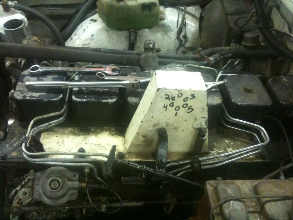

So, here's where I stand tonight. I got the aftercooled lines thrown on to see how it all fits:
The cowbell, in all it's former glory, now nothing more than a blackboard.

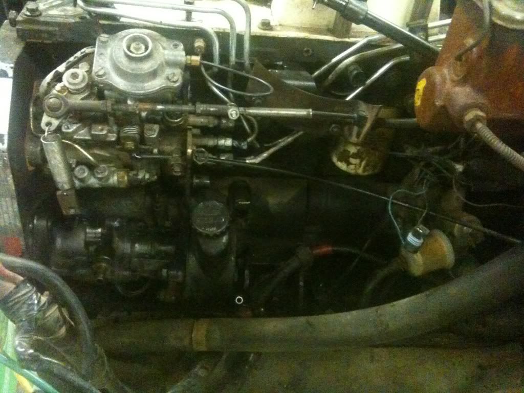

And the new vane vacuum pump and associated throttle bracketry:

the lines look home bent? maybe?
I like the distributor head order drawing on the "cowbell" I have the same on the underside of my hood 8)
and I like the throttle bracket, I cut my stock bracket down so it only goes down enough to hold my mount, but I would like to have it completely free like that.

Those lines are hella whAt? up, I think the guy had them stashed under a stack of tires or something. :lol: That forward mount for them is supposed to be one hole back, but since I plan to run the grid there I had to free it up. Nothing rubs, but I'll be tweaking on them here and there to make sure.
That bracket is actually a stock setup from an IC'd truck. It bolts up under the manifold and my truck already had tapped holes there for it. I kept my pump brace down low, since it didn't have the extra piece the IC'd one had, but it's a cutoff wheel away from being the exact same as mine.

Also, Alex, that bracket won't fit with non IC'd lines. It may with some clearancing(sp?), like I already did on that one, but the IC'd lines follow a different path up that part of the head.
Postby Hansen01 » Tue Jan 10, 2012 5:58 am
it will fit you just gotta make a cut that almost cuts it in half to clear a line :)
Postby Tacoclaw » Tue Jan 10, 2012 7:09 am
Heh, if you look real hard at my pic, you can see where I did that on my bracket. I was judging off the wrong hear under the head and just threw it in the mill and went to town. I started putting it on and found the rear hole for it. :oops:
