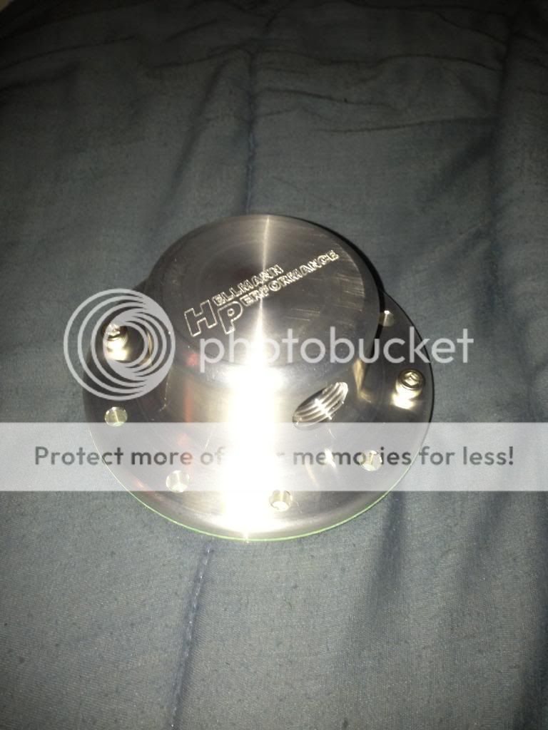

I also have a hellman sump that I got last august that'll be going in at the same time, so everything from the tank to the ip will be new(er)

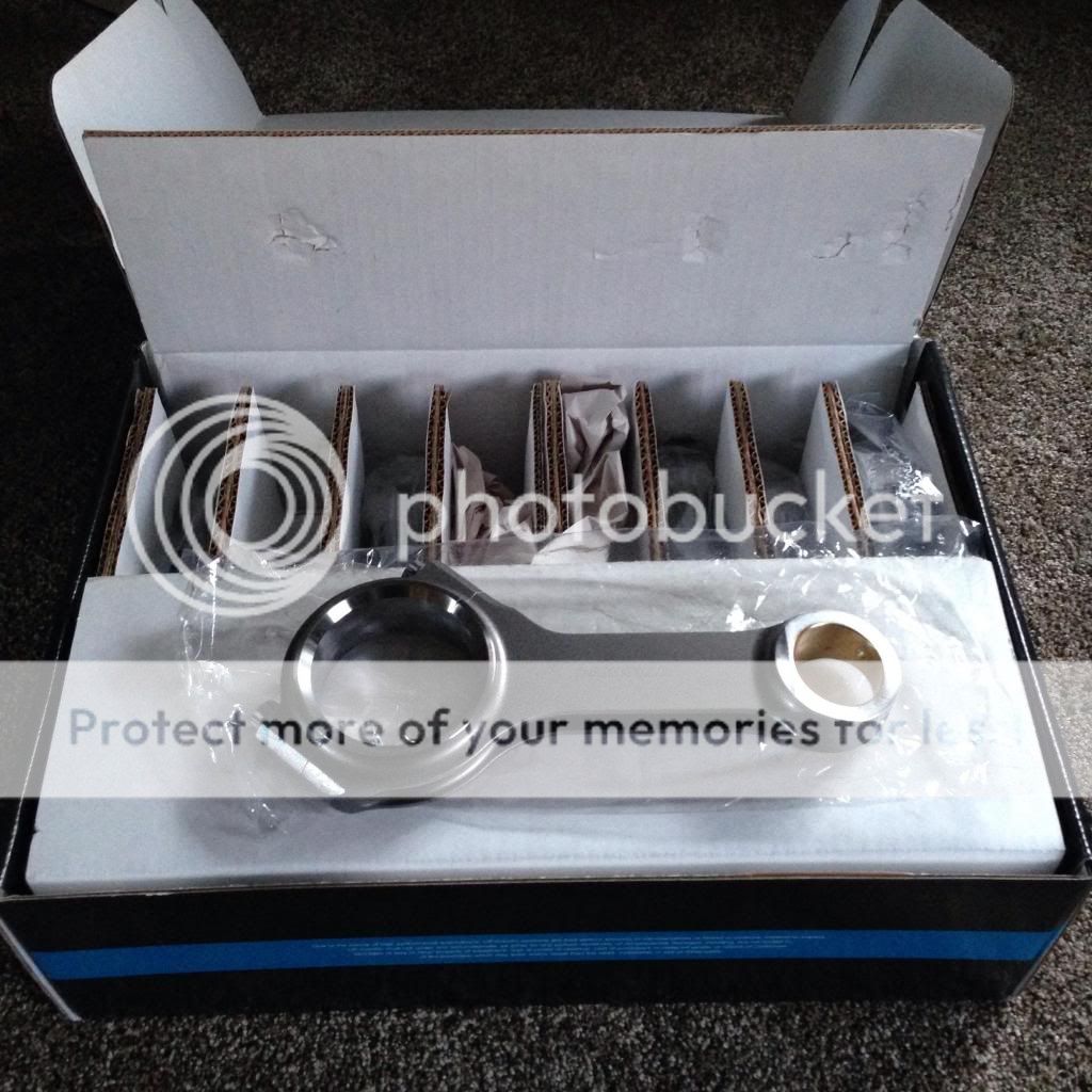

So after a little over a week of waiting I took delivery of these bad boys

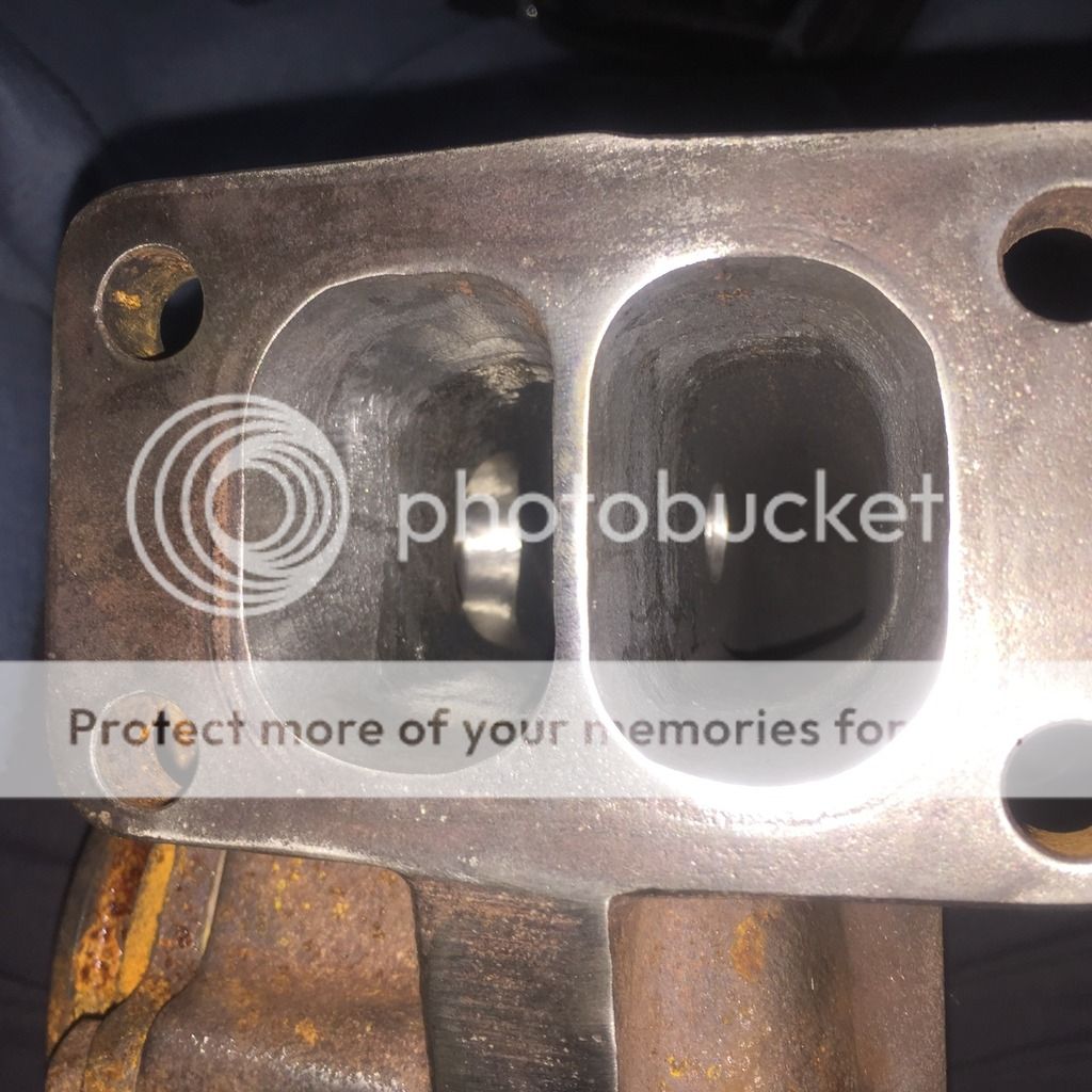

Got started on a hybrid/467 compound setup by finding some parts I'd misplaced, then figured out a spring gate acuator, ported the wastegate, drilled the divider, and gasket matched the turbine housing on the hybrid. Now I'm just working on cleaning the housing

Postby PToombs » Sun Mar 29, 2015 5:15 pm
I drilled my divider out to 3/4". Opened up the WG hole and just went all the way. Now you're laid off is a good time to get all these things done if you have the parts! ;)

Postby DMan1198 » Sun Mar 29, 2015 5:57 pm
I've got the port itself close to 1" (the back side is opened up pretty much to the height of the port) and the divider is 1/2" the spring gate is actually the one I had on my s300 with a spacer on the bolt to get the adjustability I needed.

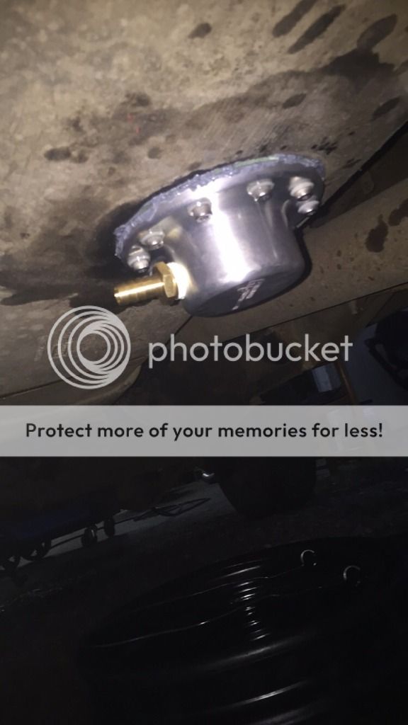

All that's left on the compounds is the downpipe (still waiting on the v-band clamp) fuel system is all done though (only have a picture of the sump in.

Nobody ever taught you how to grind welds or wipe off the extra silicone? Boy, you need a mentor! That looks like something Dudney would do! :lol:

Postby DMan1198 » Fri Sep 18, 2015 9:09 pm
I cleaned up the silicone after I took the picture. The welds on the other hand are just still there due to laziness (I did clean them up a little when I redid the primaries brace) but it still isn't finished, so I'm using that excuse

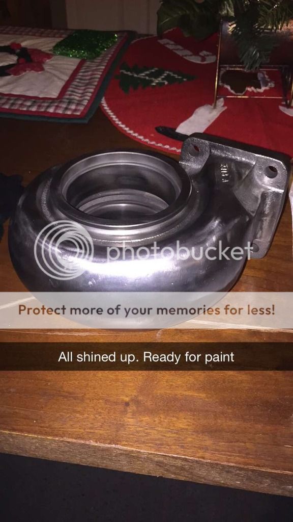

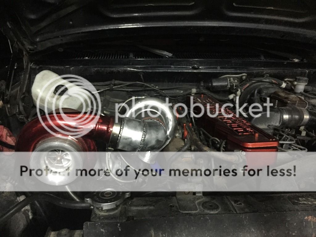

Small update. Spent 4 or 5 hours making the primaries turbine housing pretty, and got the hotpipe totally complete

Also cleaned all the rust off my steed speed, and wire wheeled it. It looks so pretty I kind of wish there was a high temp coating that was just clear. Eventually I think I'll get it ceramic coated. Probably just hit it with the header paint I have, so it doesn't rust again.
