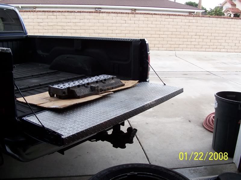

Postby DTanklage » Tue Jan 22, 2008 8:11 pm
its back....
tanked, mag'ed, and surfaced - valve faces are ground too...

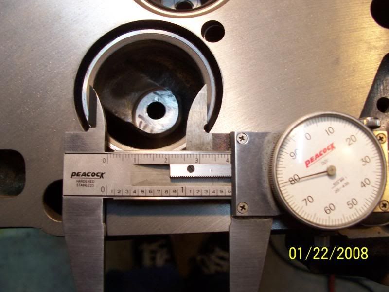

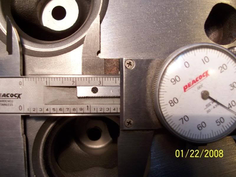

Postby DTanklage » Tue Jan 22, 2008 10:25 pm
man, the intake pockets are tiny on these things 1.440"

Postby DTanklage » Tue Jan 22, 2008 10:28 pm
ps - dont use your good calipers when doing port or seat work
the fine dust created will ruin them quick style
got those baby's at a pawn shop for 10 bucks decades ago
perfect for stuff like this

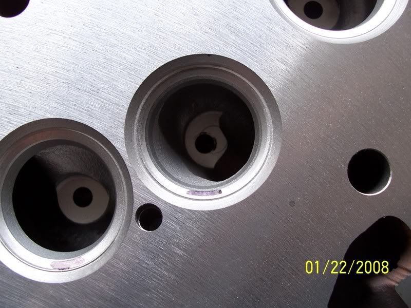

Postby DTanklage » Tue Jan 22, 2008 10:32 pm
i didnt know for sure how wide to make the intake seat
want it to last and hold a valve adjustment so i went for .080"
what do you use brian?

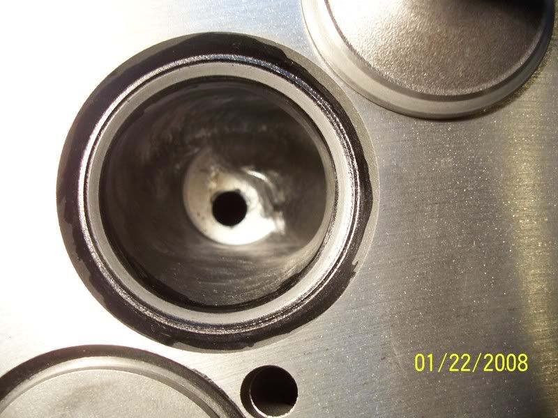

Postby DTanklage » Tue Jan 22, 2008 11:58 pm
exhaust pocket is pretty necked down too...

Postby DTanklage » Wed Jan 23, 2008 12:03 am
i made em 1.460"
which isnt that huge
hope i left enough meat for longevity?
now the ex bowls are bigger than the intake were 'as cast'
