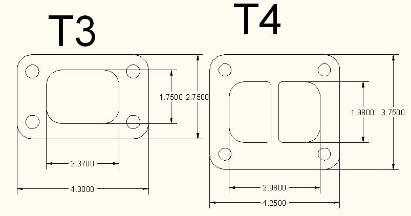

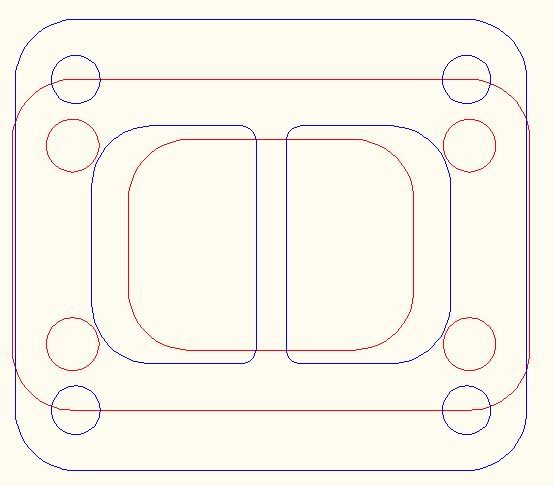

Postby ahale2772 » Wed Feb 09, 2011 6:36 pm
some drawings i whipped up, easier to see the difference,
