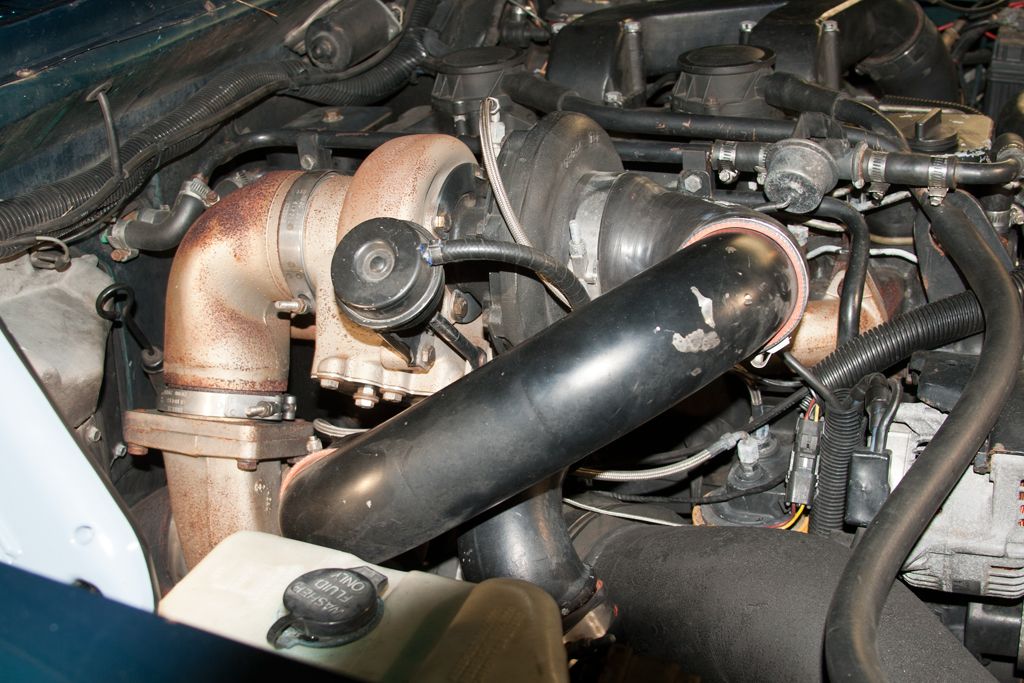

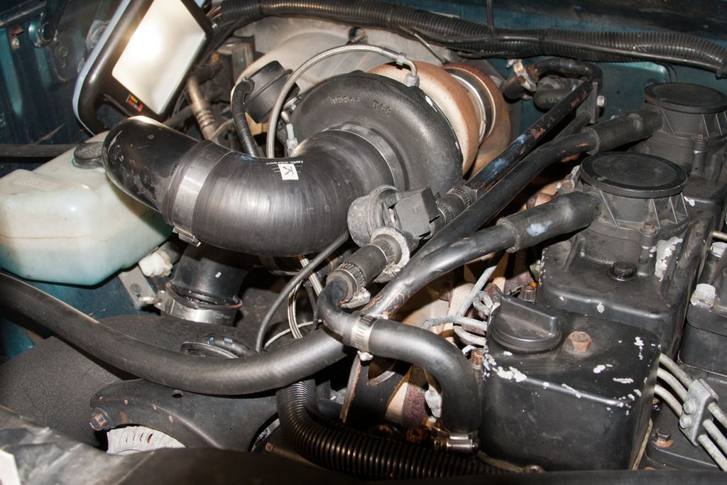

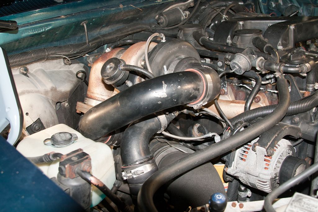

Postby BC847 » Sun Jan 29, 2017 5:54 pm
Well, got the tarp up.
This is what's coming out:
HT3B / 23(?) under an S362/65/14WG. Four inch down-pipe.This ceramic coating is right at seven years old (Cerakote product).
Four inch feed-pipe, Stock/OEM located windshield wiper fluid reservoir, and HVAC filter/drier. ATS 3-Piece exhaust manifold.
I suppose it won't hurt to clean and paint a little while I'm in there.
On that note, I've decided to hold off on doing the ceramic coating of stuff till after it's all been fitted and proper.

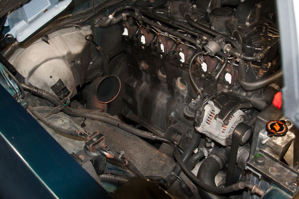

Postby BC847 » Tue Jan 31, 2017 8:41 pm
Made room for the new stuff.
With the HT3B's bearings loose, to the point the compressor briefly kissing the cover once, and me driving it for another 500 or 1000 or so more miles, I found the oil seal has failed and it's been leaking pretty good. Oil going into the secondary. :roll: Fortunately, it wasn't making it to the after-cooler so no mess to clean up there.
Found one exhaust manifold bolt loose. Like WTF?! loose. Suggests I've been a slack-ass, huh?
Anyhoo, gotta clean it all.
