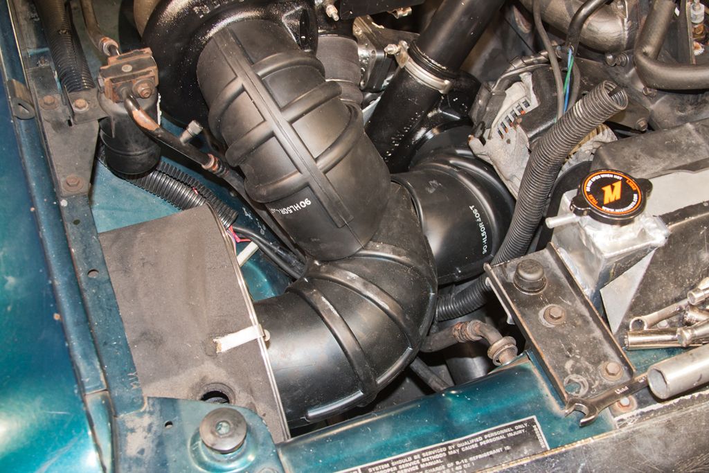

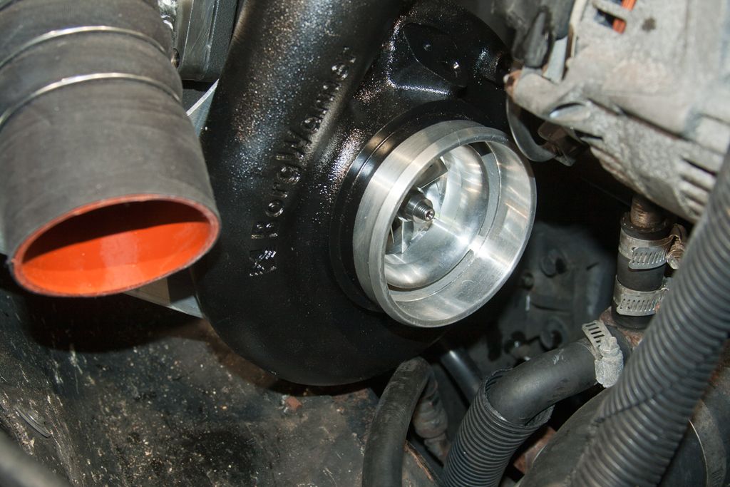

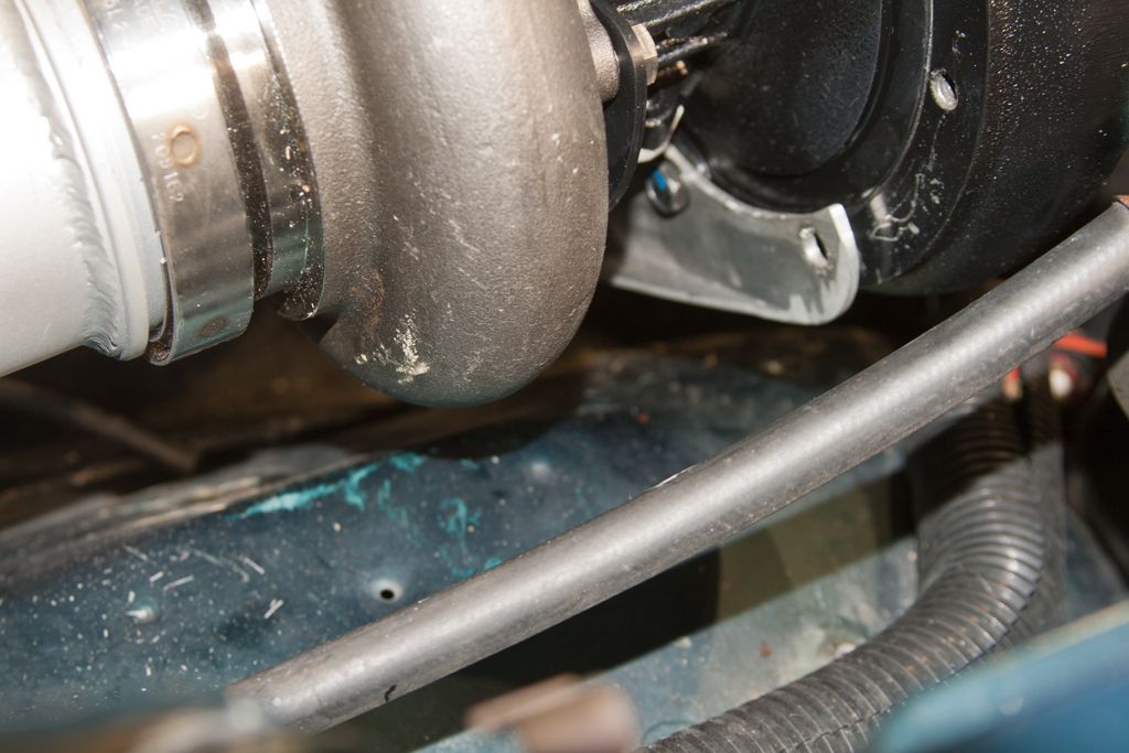

Gentlemen, I can't express how relieved I'm feeling right now. Overall things appear to initially fit better than I expected. :D
Looking a little closer at areas I was worried about . . . .

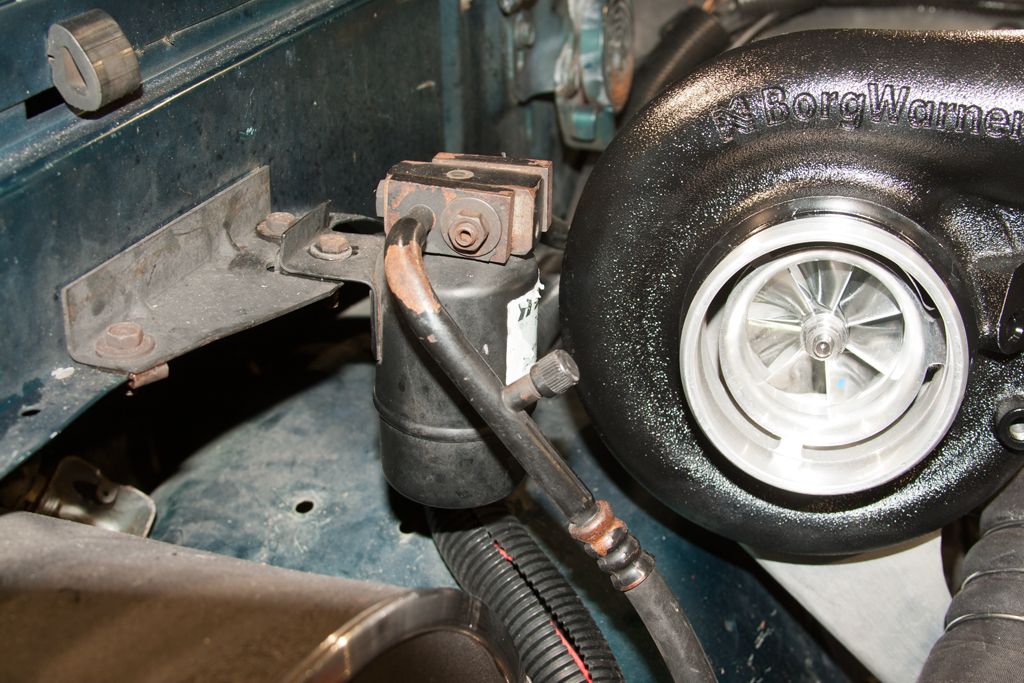

- The top primary is just behind the HVAC Filter/Drier by a good inch plus (won't have to move it). Further, it looks like I've got more room for the top primary's inlet plumbing than I thought I would. (The inlet elbow won't be all up in the air filter-housing).
- The top primary easily clears the inner fender-well by over an inch and a half (+/-).
- The bottom primary easily clears the truck' frame-rail while its inlet clears the alternator.

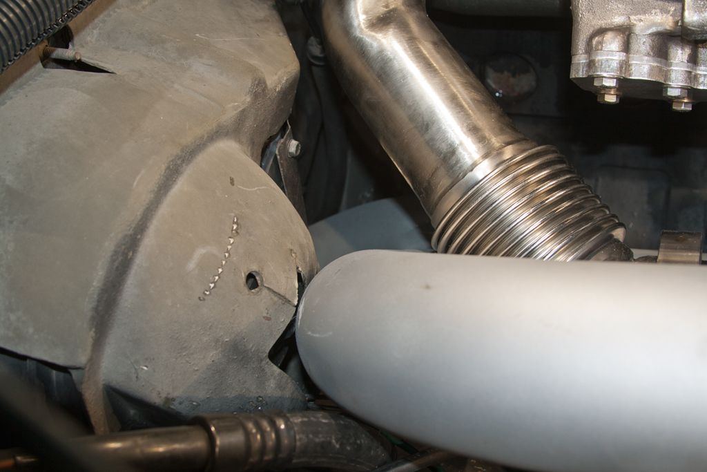

- As things initially sit, the top primary's down-pipe just kisses the HVAC blower's motor. :oops:
- I believe I can fix that by swinging the main 5" down-pipe away from the transmission bell-housing (modify), then swing the entire mass back toward the engine thus getting the top primary down-pipe off the heater HVAC motor. Frankly, I'm floored the thing fell damn-near Spot-On where I wanted it to.

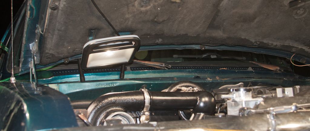

- The overall package appears as though it will clear the hood.
I will say that, assembling the mass in place was a pain in the ass. With all the hot and cold plumbing rigidly attached with V-Band clamps, proper alignment of everything is critical. Supporting the mass while leaning over the fender, twisting/tweaking this and that, to get each section to come together was trying. At best. :roll:
Still, I'm kinda proud of myself. :mrgreen:

That looks just mean! 8) An inch is going to be close when the engine torques under load. Mine is 1/2 to 3/4 from it and I can see the mark in the paint where the big turbo hits the fender. I'm not sure how old my motor mounts are either, I can't remember if I changed them or if they are original. :lol:

- Can't turn the bottom primary 90* up anymore for being on the alternator now.
- If the 90*'s generally stay as seen, I'll have to route the secondary outlet to IC line over the mess.
All things considered, I may have to dimple/flat-spot/crush/something that top down-pipe where it contacts the heater motor. (Alternator/primary, top primary/fender-liner, top down-pipe/heater motor, 5" down-pipe/resilient mount/trans bellhousing, etc. :roll: ).
