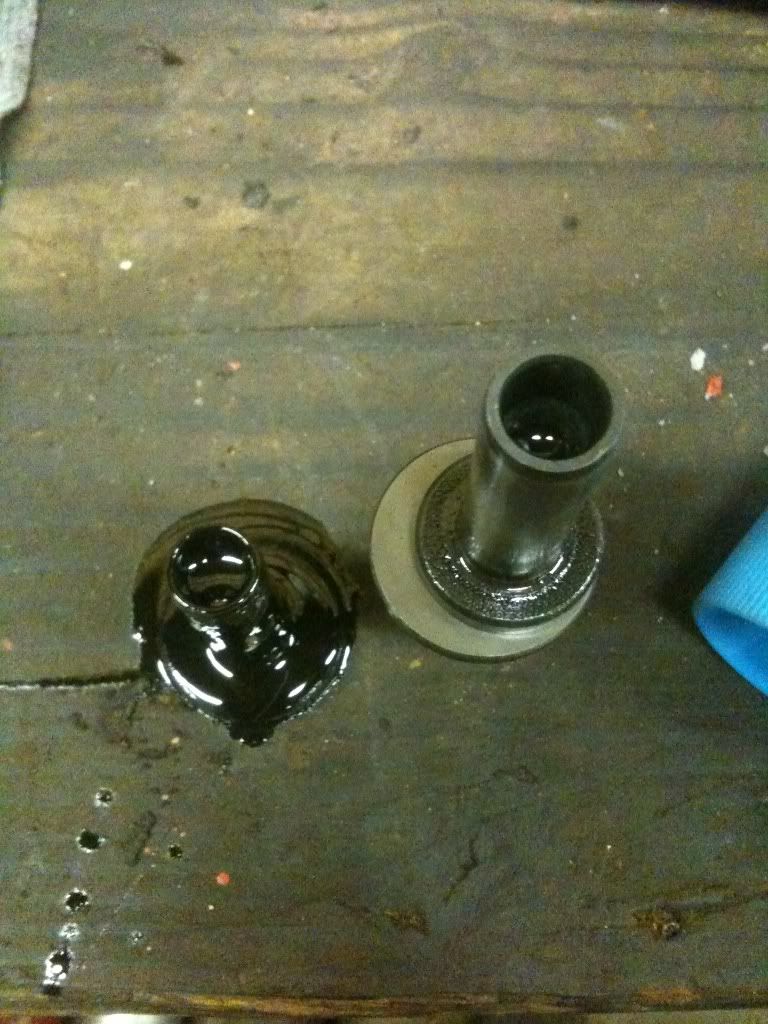

Strike one!
Here's the offending lifter with a comparison of a 12v and 24v lifter.
This should explain why your cam trough has to be as thin as possible. They're a lot wider.
Postby PToombs » Wed Feb 01, 2012 6:05 pm
Do you need the 24v lifter? I don't remember anyone saying why they went to them when they swapped the cam.
Postby ahale2772 » Wed Feb 01, 2012 6:10 pm
wider lobes on the hamilton cams Pete, less wear
Postby Tacoclaw » Wed Feb 01, 2012 6:17 pm
Yup, a wider contact area lessens the surface PSI that the oil has to withstand. Apparently the CR lifters are even wider, but I've never seen one.
Postby oldestof11 » Wed Feb 01, 2012 6:39 pm
PToombs wrote:Do you need the 24v lifter? I don't remember anyone saying why they went to them when they swapped the cam.
Hamiltons cam lobes are wwwiiiiiddddeee. He recommends the 24v lifter because of this. And as said before, wider lobes + wider lifters = less lbs per square inch for durability and longevity.
Postby PToombs » Wed Feb 01, 2012 6:40 pm
Now that Alex said it I do remember reading it. This damn old guy siht is getting old! :x Wider is better with the 60lb or heavier valve springs for sure.

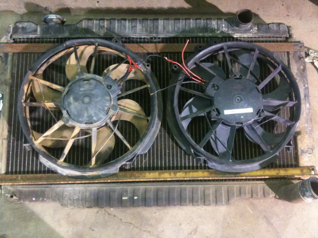

I took a break from the serious stuff and threw it together enough to get an idea on my intake piping. While the radiator was in there I decided to fab up my fan mount.
That's one of the big fans on the left, and a smaller one that mounts and rotates in a mirror of that one. I've got them both bolted down now, but came in before I took a pic of it. I'm going to weld some 1/2" ID pipe to that bottom angle for those feet to sit in, then have them held with the one bolt at the top.
Dunno how I'm going to control them yet, thinking just have the baby kick on full speed once it hits 190* and have them both on full blast on a switch in the cab. Time and patience will tell if I get ay more in depth than that.
