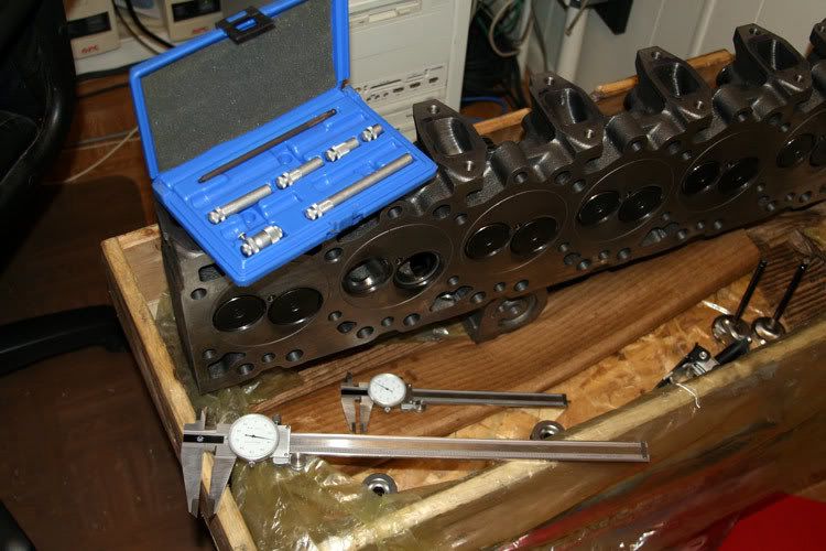

ps - did ya ever measure the pockets?
just stick your calipers in there and see how wide they are
(side to side)
curious
thanks

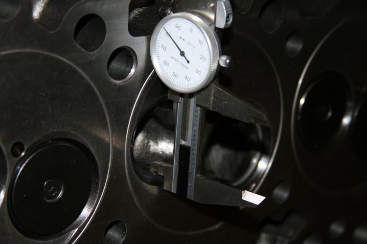

Pockets . . . . The throat of the port immediately after the seat? In further .25", .5" ? Side to side looking on axis down the port? (I'm funny that way).
Crap! I need my durn inside protractor! I've got precision bore guages from 1.500" on up to well over 8.000". With such, I can only measure the height of the port.
I've got killer precision dial calipers, but like you the inside side only reaches a half inch or so. :oops:

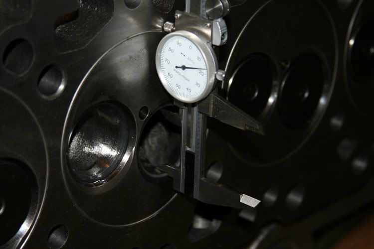

Postby DTanklage » Fri Jan 25, 2008 11:33 pm
can you measure the pocket vertically (with the head on its side like it is in the pic)? (that would be side to side when its on the motor, right?)
with the calipers, the 6" ones will work just fine
don

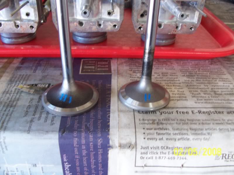

Port flow 101
when fluid meaning air runs in a tube of varyin shapes ( a port) it doesnt want to bend and makes eddy currents that reverse flow, when it is forced to go around corners
In an attempt to prevent that, a Dr of engineering over in England ( i forget his name and the book is packed away) who pioneered most of todays porting technigues ( a rich european version of Smokey Unik) and came up with all kinds of neat little things to straighten an ease flow thru a port and was doin this stuff way back in the forties n fifties.
the number one thing he came up with was a "ratchet" which a first he used in the port itself just behind the valve seat, and then realized that one could do almost as good job preventing stall and reversion by making the same "backcut" or "ratchet" in the back of the valve head. There is a complete science to depth and angle of this cut and its placement on the back of the valve head.
This Dr was also the pioneer of the multiple angle valve and seats
Yes many machinists today mistakenly call multiple angles that lay back the edge of the valve "backcutting"
Multiple angles work best on an intake valve as it helps stops turbulence
Multiple angle on an exhaust valve tend to burn away too quick, and should be reserved for race only motors where they are touched up regularly
In any event most performance valves today are made with the "backcut" already incorporated in the back of the valve head - just as in the pic of the valve on the right side in this post. (This particular machinist was quite correct in what he called it)
Why - its a cheap increase in flow in any motor - it had nuthin to do with weight savings - thats what reduced stems were done for

Postby BC847 » Sat Jan 26, 2008 8:38 pm
DTanklage wrote:can you measure the pocket vertically (with the head on its side like it is in the pic)? (that would be side to side when its on the motor, right?)
don
Sorry about the delay.
As you may know measurements are approximate. The intake is about 1/4" in there @ 1.52".
The exhaust is about 5/16" in there @ 1.38".

Postby DTanklage » Tue Feb 05, 2008 8:22 pm
BC847 wrote:
Speaking of valves, be sure to keep the swirl on the backside if you whittle there ~
you had asked about back cutting and how to tell if they were back cut. this is what mine look like now:
the ex face is 45° so it is back cut with a 30
the intake face is 30° so it is back cut with a 15
tank
