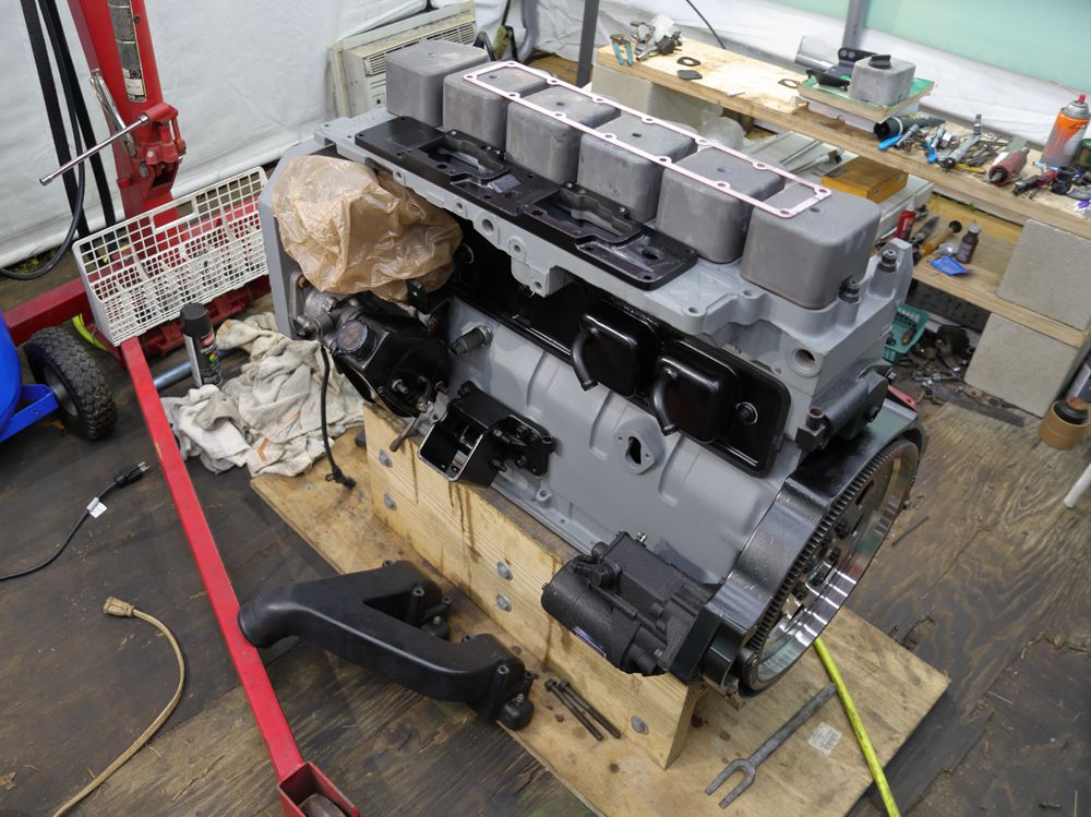

Moving forward . . .
Set the short-block upright in its cradle.
So, I've been running two of the fancy valve-cover crankcase breathers.
You know what? The crankcase gasses must first travel through the tappet/push-rod box before they get to the valve-covers. :shock:
I'm gonna do away with the valve-cover breathers so I can do something else up there. I got this parts-engine so . . .
It should just clear the fuel-filter.
We'll see, huh?
Postby BC847 » Thu Oct 01, 2020 6:44 pm
Been messing around with nailing stuff to the short-block. Still got a little more. Might start working on the head this weekend.
I don't care for the apparent reliability of the O-rings on the fancy Freeze-Plugs. While they aren't really that old, during cleaning the things, I found that the surface of the O-rings were starting to crack. Screw having to fix a leak right down the road. I replaced them with the standard freeze-plugs. The ones that last 25 years or so.
The dual crankcase-vent mess fits just fine.
