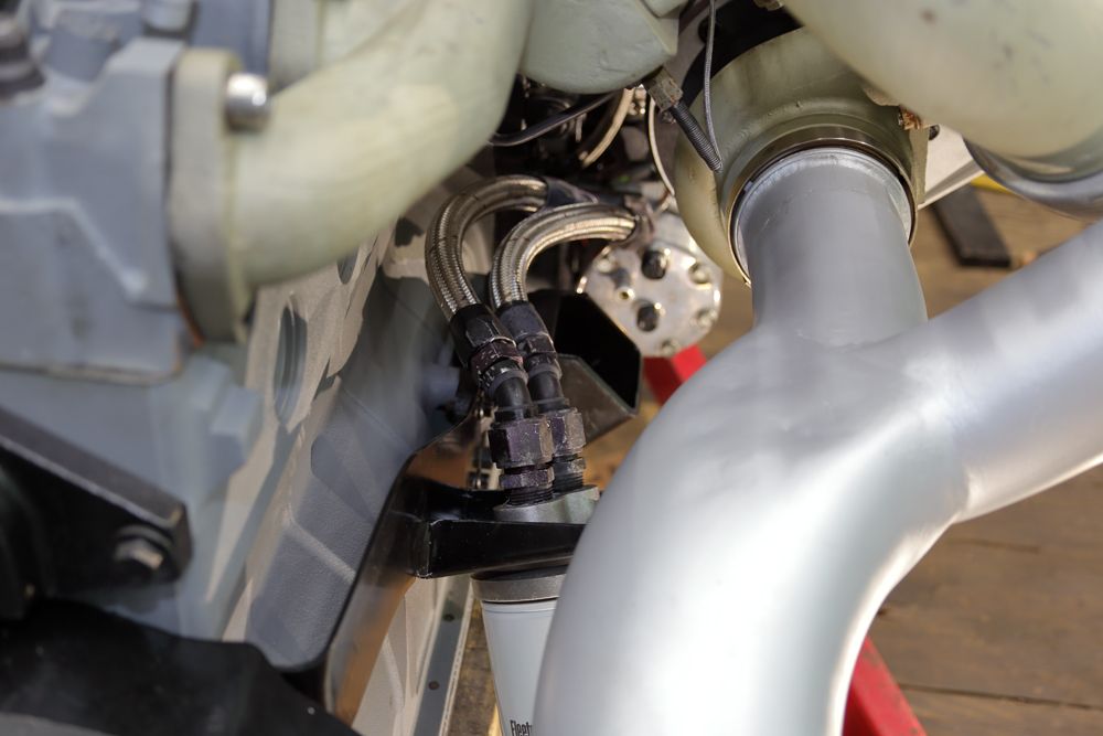

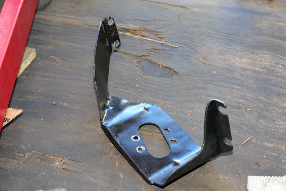

So, back when I first installed the triples, I had to relocate the engine lube-oil filter. I made a bracket for the filter-head that was OK but, when I installed it, I found that I had forgotten about that turbo lube-oil drain port on the engine oil pan. DOH! I had to grossly tweak the bracket to have the oil filter clear the one turbo oil drain port in the pan.
With this new build, I have to opportunity and plenty of room to fabricate/fit a new bracket that clears the two oil drain ports in the pan.
The former ugly Bracket:

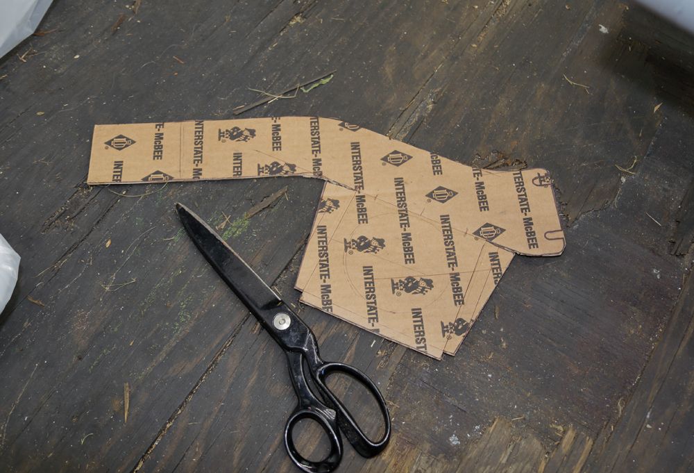

Do some ciphering and make a template:

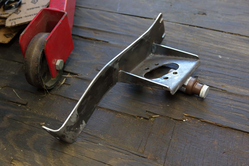

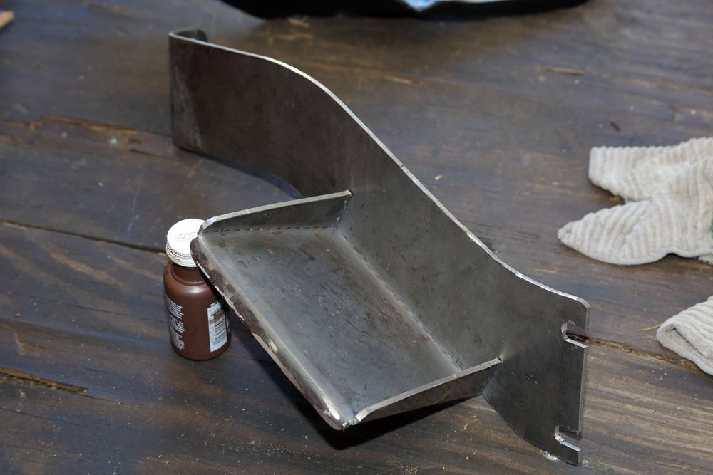

Transfer that to some 1/8" thick plate-steel, Cut it out and fold it up:
Cut/drill the opening for the filter-head and associated mounting bolts:

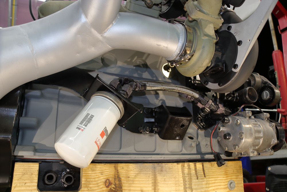

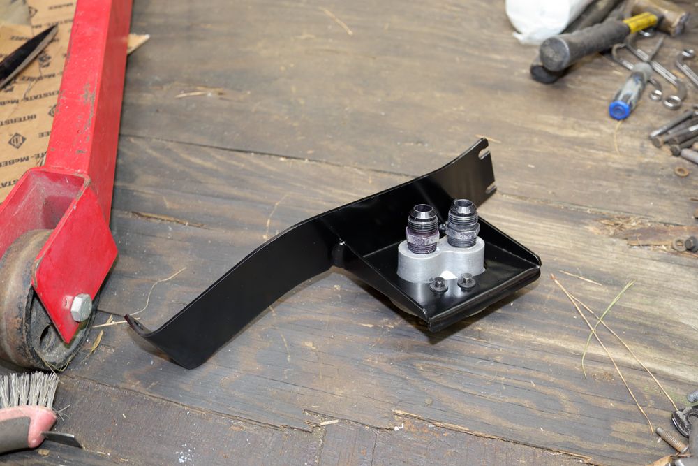

Paint and assemble:
Install and shorten/fit the hoses:
The hoses are well away from the hot stuff.
I think it turned out pretty well considering it was made with a jigsaw, anvil, maul and drill. :)
