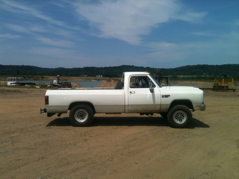

I still wasn't sure if the pump was alright or not, so I decided to put it to the test. Drove around all night last night and then went to work and picked up a couple tons of #4 gravel. This was exactly 2 tons, it grossed at 9640. Kinda sad that that's not that far from the factory weight on some Ford trucks I've been around recently.
I swear those springs are some kind of practical joke spring. There's no way it can ride as rough as it does and still squat like that the second it gets some weight on it.
Postby oldestof11 » Sat Jun 09, 2012 12:27 pm
Shorter spring lengths do that it seems.
