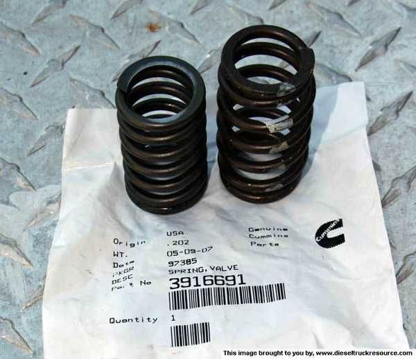

Can someone provide me with a thickness of the spring coils and/or the number of coils of a 60lb valve spring? I want to ID my truck to see if it has them or not. The ones on there look pretty beefy.

sotck valve springs shoulde be about 56 mm long and about 34 mm wide. roughly

Stock/OEM (left), Cummins 60# (right)
The 60# spring is Beehive shaped.

The 60lbers are pretty big, they take up almost all the room provided between the valve and the valve cover.
