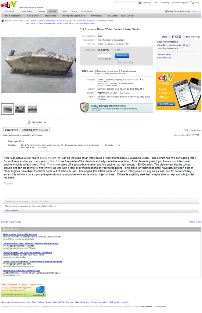

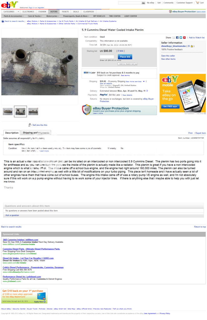

I have learned and studied and read a lot. And I am a big supporter for Water-To-Ait intercoolers. Now I have seen these and never thought about it till I find it last night.
Was wondering if something like that could be setup on a system like this
http://www.votionspeed.com/servlet/the- ... -to/Detail
Since my first gen is going in a 197f F250 4X4 and space is limited, I want to run a water air intercooler with Water/Meth injection so I plan on running the bottom kit cause your never spouse to shoot water meth before your intercooler. But would it be possible? Plus that pic may spike someones intrest who wants or needs it and its on ebay. Here's the link
http://www.ebay.com/itm/5-9-Cummins-Die ... 1c26207d57
Just wonder if anyone is running one and wanted to let people know there are some nice option out there....

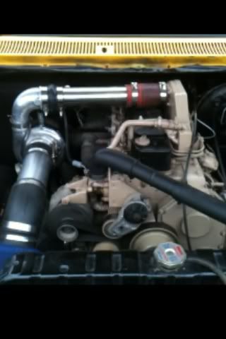

I'm running an air to water, and unless you're working your truck extremely hard I haven't found the need for a reservoir that big. I'm using my washer fluid reservoir for my air to water, and even after about seven 1/4mile runs as hard as I could get it the water coming out of the return was still ice cold. I'm just using an AC condenser out of a Chevy 2500 with a 6.5 diesel.
I will mainly attribute that to the factory mechanical fan, since I had it pulled off and didn't have my electric fans hooked up and the water coming out of the return got hot within minutes of driving, even at a normal pace.
Here's how mine is laid out: (last post on the page)
viewtopic.php?f=4&t=5512&start=210
It would have been awesome to find one of the factory-style ones, but I just didn't have that luxury at the time. It would be just as easy to run one of those into my AC condenser, but they are made to be hooked straight into the existing coolant lines on your engine. (I don't know if they'll interfere with the factory trans cooler or not, since it uses coolant as well and there's only so many places it can get it from.)

Postby PToombs » Mon Apr 23, 2012 4:09 pm
If you get that aftercooler, you need the injector lines that go with it. They are bent to go around it, stock lines won't fit.
It doesn't matter which way you install it, and it will fit a P-Pump engine, with the correct injector lines.

Postby SuperiorRam » Wed Apr 25, 2012 3:05 am
This is the second one I've had they are pretty cool
