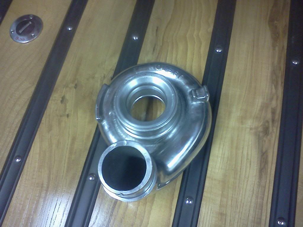

this turbos awfull big
after 5 hrs of sanding and polishing

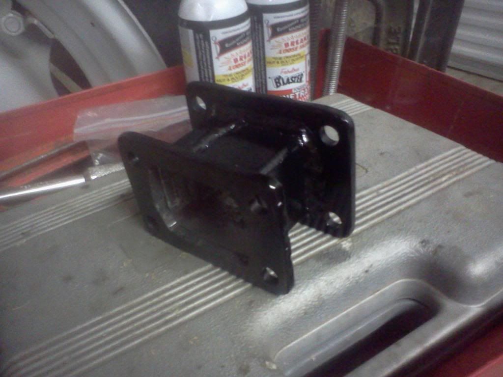

Custom adapter

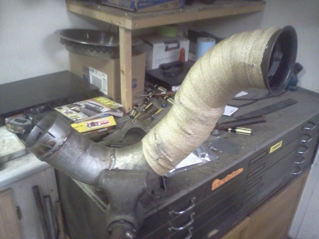

custom 4inch downpipe its a tight fit but no rubbing
all together, then i ran PTO cable inside of the cab to control it

What did you need the adapter for I thought the He 351ve had a T-3 foot also.

ve's have a different flange from a t3 or t4 or the t4i. from what i've researched its a wgmt flange or something.
edit: the 351cw have the t3

This one came off a 2008 6.7. It has the t4i flange. It spools good and make some good power and keeps the egts low with those pod injectors. The whistles loud with it closed up but u get used to it.

Some good info,nice sanding and polishing job 8) If im not happy with my EGT control now with W/M im going to look at this HE 351cw turbo for the true 4" exhaust.

Did you have to flip the exhaust manifold?

No I didn't haft to flip the manifold it fit snug though but it all clears even with the 2.5 inch eletric controller I had on it at first
