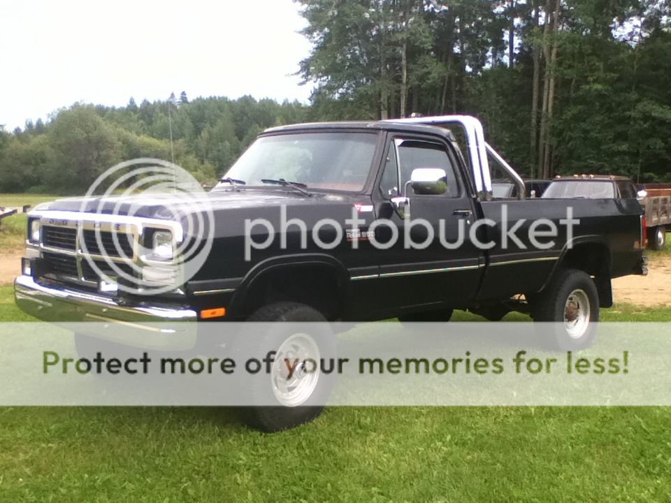

I'll start off by giving a little background on the truck. My dad bought it from the original owner already turned up and turned, but all stock around summertime 2004 kind of as a spare vehicle I think. anyways it got occasional use mostly hauling water, our toys, and picking up parts for the business after we sold our 04 dodge dually (my dad ran a machine shop for a while. Still has most of the equipment too). Occasionally it was DD'd until we get to September 2010 when I started driving it.
shortly after that I was having a conversation with my dad where he mentioned the p pump in the shop could be fitted to it, and that's where the seed was planted to give it an inline pump. then when I bought the truck off my dad and got my new plate the decision was made to shoot for the number written on the plate (1209)
Things went well the first winter. No accidents and I enjoyed driving it. by the next fall I'd burned most of the tread off the back tires, so I had to get new ones. In January I picked up a new exhaust system (it was the flowmaster 3.5 dp back exhaust and not the one I wanted) and all chrome front bumper. then things went poorly. one night driving home from work after it had been raining, and that rain had frozen, I ended up hitting another vehicle with the side of mine (it wasn't pretty) it turned out there was actually a LOT of bondo on the truck from other accidents.

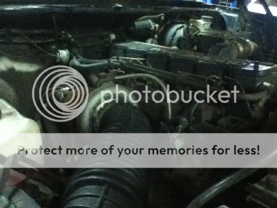

Finally I had my pyro mounted pre turbo, and discovered I was hitting 1400 degrees. Late January I got my DDP fuel pin, and went from 38psi of boost to 40. Then in February I started assembling parts to meet my lofty 1200 horsepower goal. I started with parts for compounds

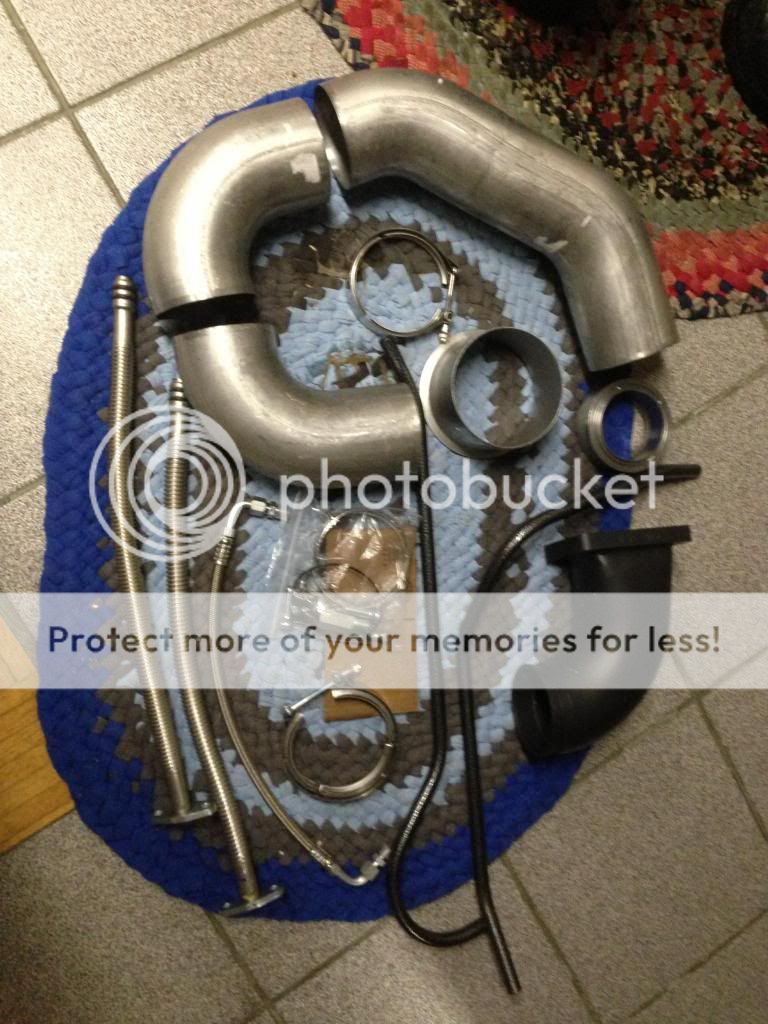

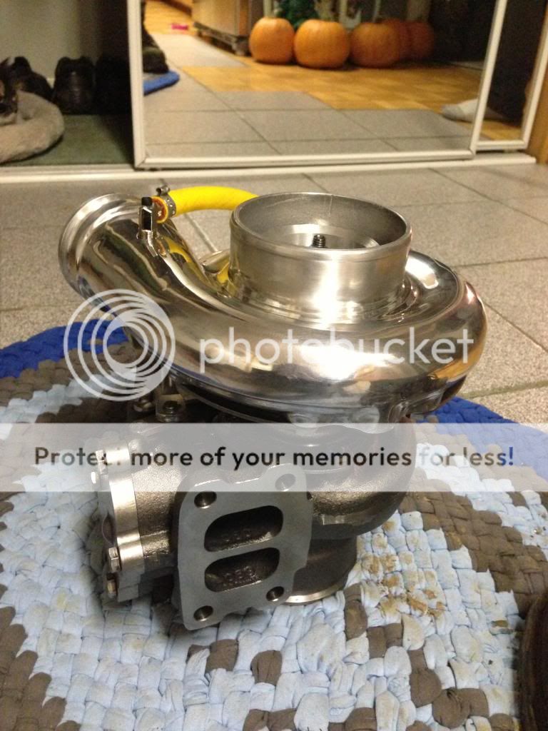

Unfortunately I didn’t do enough research before ordering and the hot and cold pipe won’t fit so I am going to actually build all my own stuff. At the end of February I ordered my silver bullet s362 from industrial injection.
I drove it for about a month like that till this happened

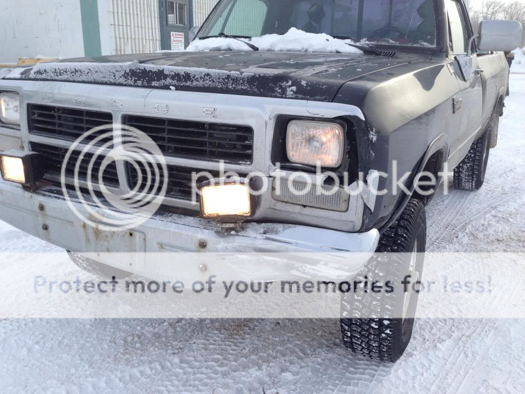

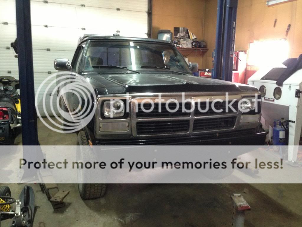

I also forgot that about a year to the day of my first accident with the truck I ended up in another accident that caused front end damage
so I pulled the front bumper off and decided I'd get around to building my own bumper sometime. that sometime turned out to be the middle of May. I got a 3/16" wall bar for free and 6 feet by 8 inches of 3/8" steel plate, and took my first try at welding

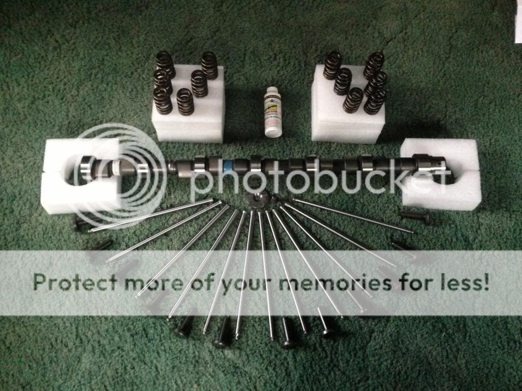

In April I took the liberty of ordering the pump I wanted. it ended up taking over 4 months and several phone calls before it even shipped, and when I got it nothing came with it so I don't even know what's in it. In June I decided it was time to order my cam and whatnot, so a call to Hamilton, and I had a 188/220 cam, 165# valve springs, extreme duty pushrods, and a new set of tappets on there way.
