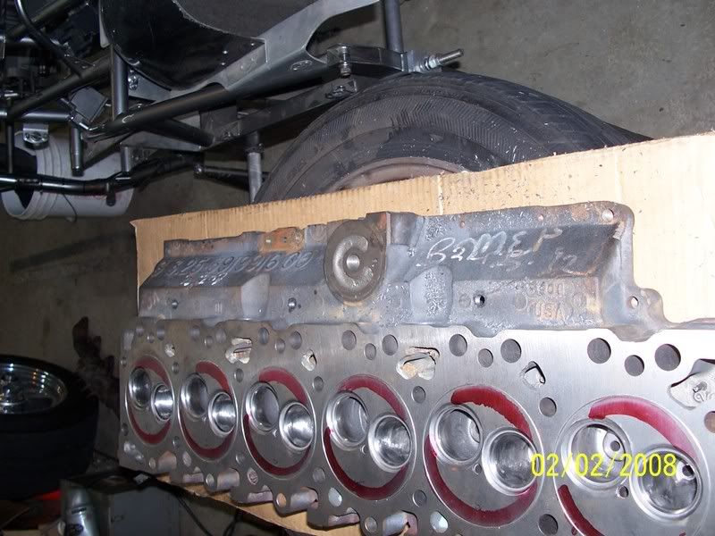

Postby DTanklage » Sat Feb 02, 2008 10:00 pm
how much do i have into mine...lemme see: hot tank, mag, bead blast, grind valves, back cut valves, surface head, and hot tank one more time to get rid of porting junk and glass bead $150. cut groove for o-rings $60. machine rocker stands $10

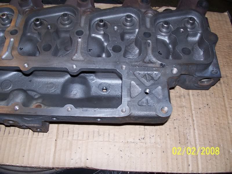

Postby DTanklage » Sun Feb 03, 2008 9:50 am
another thing i did while the head was off and apart was i drilled a bunch of holes in it
dont you hate it when you are working on your truck and you need to put a nozzle somewhere or get boost reference somewhere and there is not a hole?
i do

Postby DTanklage » Sun Feb 03, 2008 9:53 am
in the future i may want to hide some nos on this thing
who knows?
a little 3 nozzle system
could even use those 3 holes for the 625 water nozzles?
