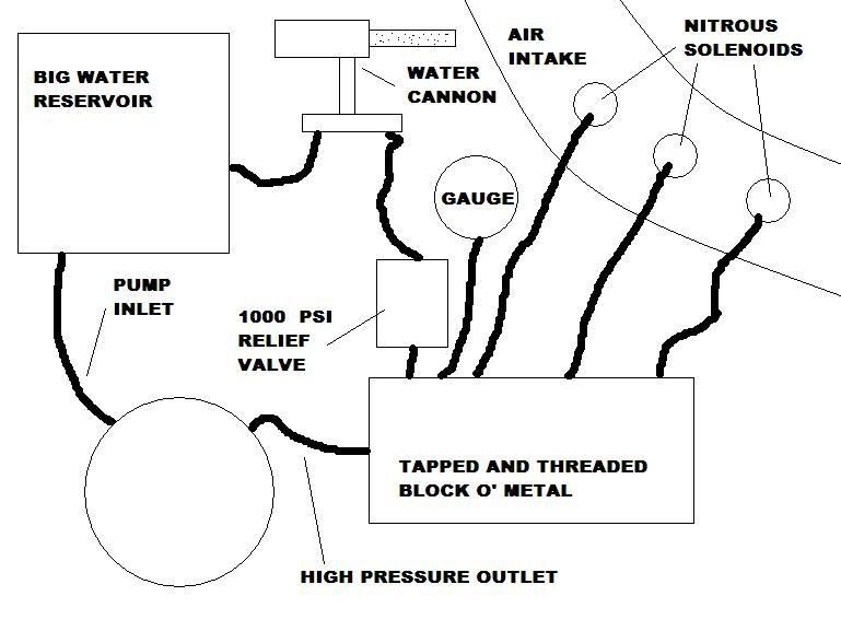

How do I get this to work as a water injection pump?

Postby Begle1 » Sun Apr 06, 2008 7:24 pm
rbrettctd wrote:ditch it and bust out the $75 for an actual pump? :lol:
I already got one of those little Shurflos, but this one does 3000 PSI!
Would this work?
Would the reservoir have to be pressurized? Do relief valves work like pressure regulators? Anybody know if there's such a thing as a 1000 PSI relief valve? Nitrous solenoids would work with water, right? Are they big enough?

Postby oldestof11 » Mon Apr 07, 2008 1:36 pm
Hydraulic pumps make more PSI if you use oilas it is thicker. I would bet that thing push MAYBE 600 PSI on water. The drive mechanism probaly NOT set up for water so things inside might not have as close of a tolerance as a water pump.
HTH,
Postby KTA » Mon Apr 07, 2008 3:05 pm
Looks like a power steering pump to me. It probably has an internal pressure relief already.

Postby cummins king » Mon Apr 07, 2008 3:06 pm
also the durability of water going througha hydrolic pump is questionable
93 4X4 auto
cummins king
Posts: 1741
Postby PToombs » Mon Apr 07, 2008 3:30 pm
#1, That's a Fisher snowplow pump.
#2, It's a gear type pump, no pressure relief in it. Relief valve is in the control valve on this system.
#3, Water will rust the inside of this so fast you wouldn't believe it. If you let it sit for a couple of days, the bearings and gears will start to rust, and then you'll be pumping that into your engine.
#4, On a gasser that runs 1-1. I have gone 1 and 2 inches smaller and didn't hurt them any. I was using it on a plow though. ;)
Hope this helps ya! :D

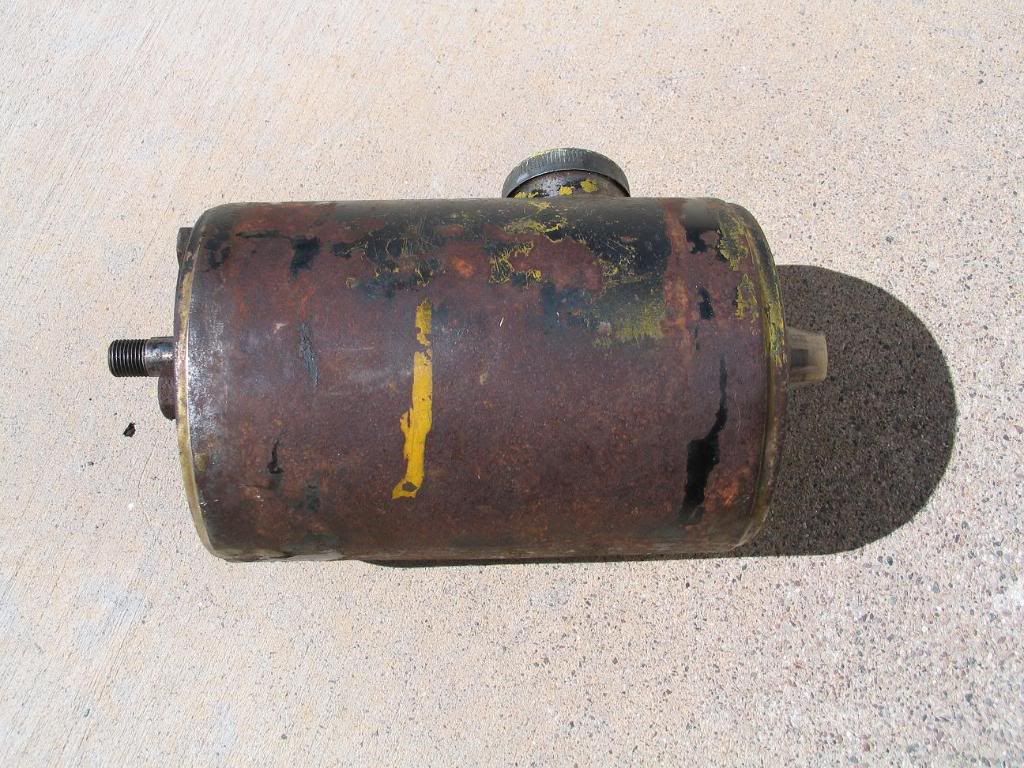

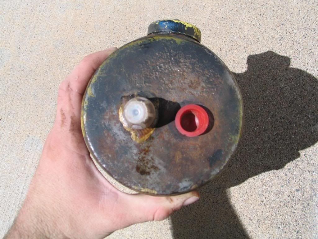

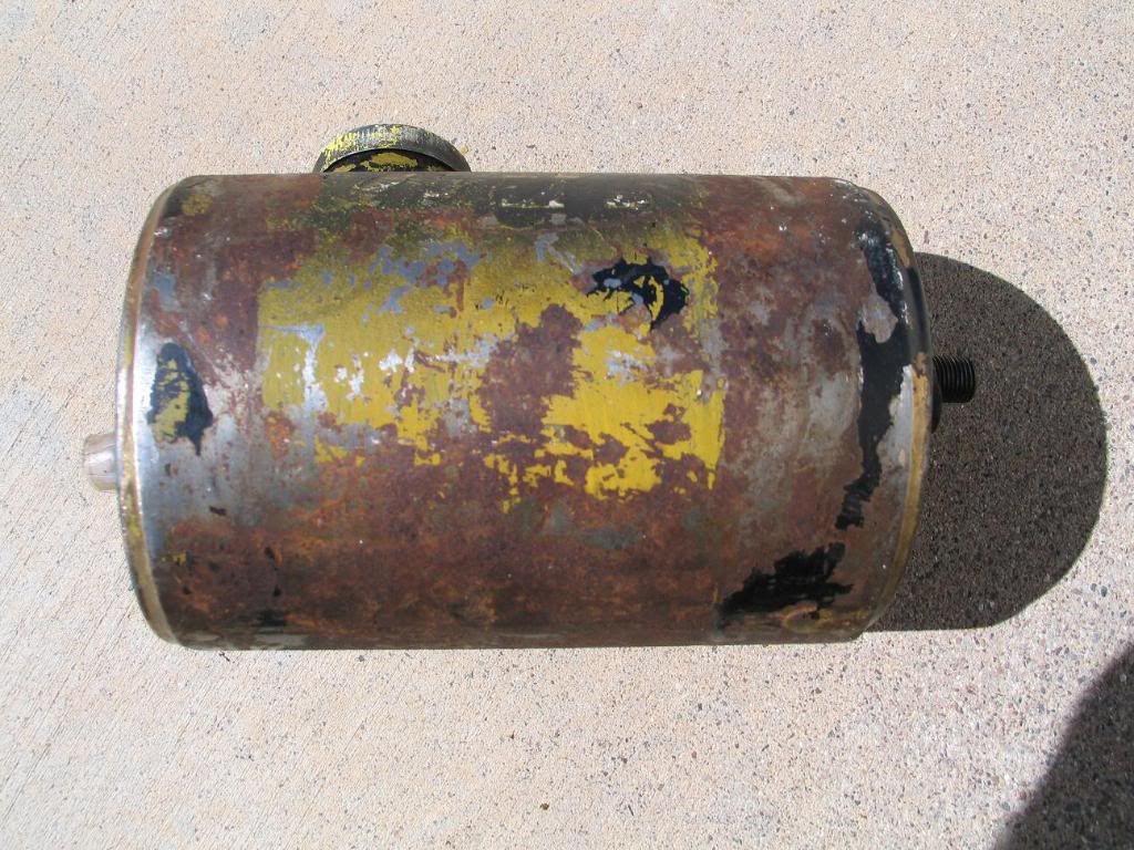

Postby Begle1 » Sat Apr 12, 2008 6:12 pm
Alright, I got the pump in the mail.
5-inch pulley (outside diameter), 1/2 inch shaft, 1/2 inch inlet and outlet.
Now, I looked all over this thing for some kind of identifying mark, and there isn't a one.
Any ideas on how to find the specs for this thing? I looked through Fisher Plow's website, and they don't mention pumps anywhere...
Any experienced guesstimates on what it's going to flow and what RPM it's going to destruct at? Those two things are all I really care about...
1:1 ratio on gassers, that means that pump RPM equals engine RPM? For a 1:1 ratio the pulley on the pump would be the same size as the pulley on the engine, right? A smaller pulley on the pump would make the pump spin faster, bigger pulley would make it spin slower?
I took some pictures for the sake of documentation.
http://i159.photobucket.com/albums/t130 ... /Pump1.jpg
http://i159.photobucket.com/albums/t130 ... /Pump2.jpg
http://i159.photobucket.com/albums/t130 ... /Pump3.jpg
http://i159.photobucket.com/albums/t130 ... /Pump4.jpg
Begle1
Posts: 1968
Location: Kihei, Maui, Hawaii
Postby PToombs » Sun Apr 13, 2008 9:26 am
I don't know where to find specs either. It looks like a 70's vintage pump.
Yes, that's exactly what 1:1 means, and you have the pulley size thing figured out. We used a 3 inch on them with no problems. If we went smaller, the belt would slip when we raised the plow. A combination of not enough belt contact on the pulley and the pressure needed to raise the plow.

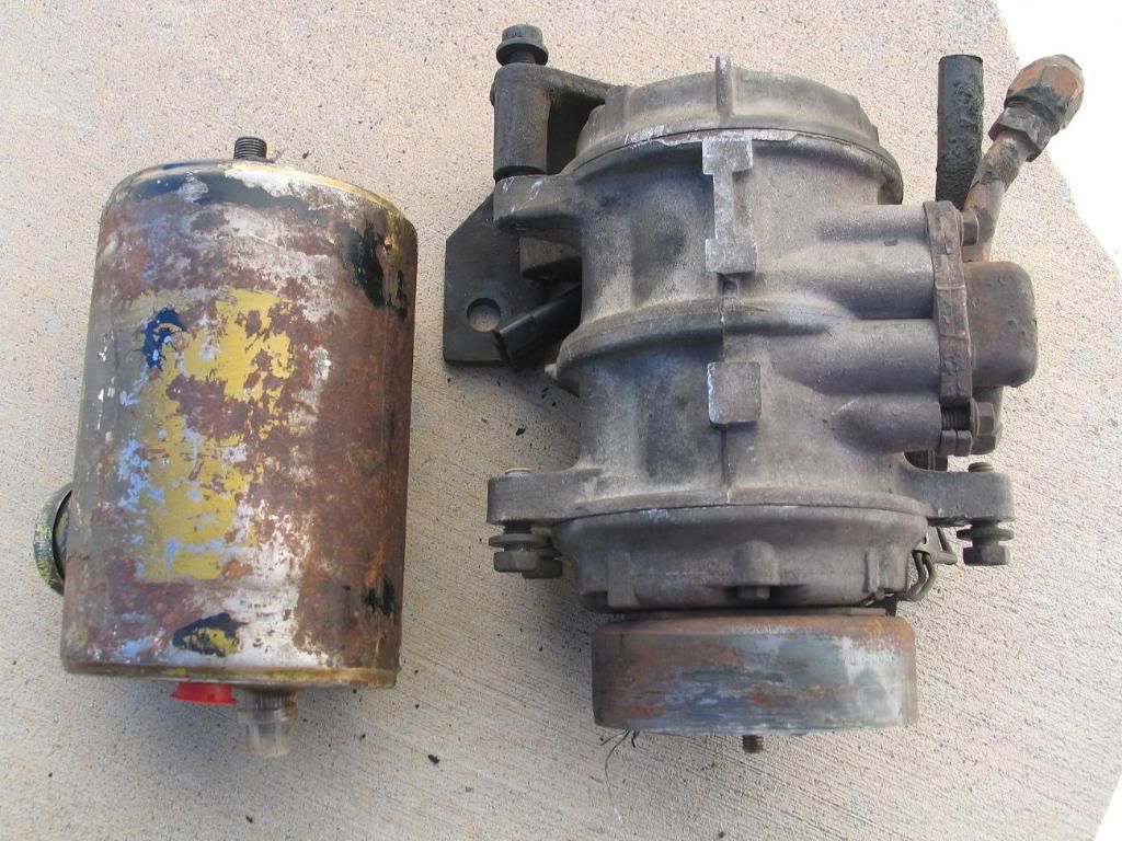

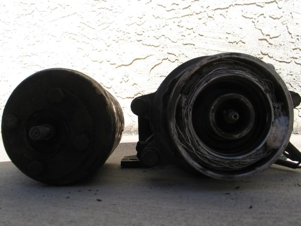

Postby flashgordon » Sun Apr 13, 2008 11:19 am
correct me if I'm Wrong but, that is an A/C compressor....the one on the right in the last pic....................
And if it is a A/C compressor...................does the compressor not compress gas (Vapor freon) not liquid????? or do i have this backward?????
Flash.
91.0 non intercooled 3/4 ton 5sd ex.straight piped 16cm housing, timing bumped 1/16...Pump . Full power screw1/2 max with out removing the collar. Gear Vender over drive!
"NOW" with 2nt gen intercooler, turbo and 3"Coolertubz, Buy Tim (TWorline)"
flashgordon
Posts: 280
Joined: Sun Jan 07, 2007 8:50 pm
Location: Evanston Wy
Postby Begle1 » Sun Apr 13, 2008 2:02 pm
The one on the right is the stock air compressor that I took off my truck so that it would go faster.
The one on the left is the hydraulic pump that I'm going to put on my truck so that it will go faster.
They got the same size shaft, seems to me like I gotta find a new A/C clutch to mount on the hydraulic pump.
Need to find a way to mount the pump itself too.
