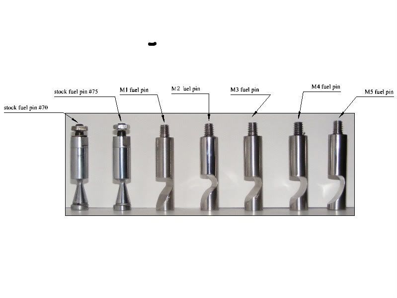

Postby cougar » Sat May 16, 2009 3:06 pm
First time I've heard of them. Where can I get info?

Postby BC847 » Sat May 16, 2009 3:19 pm
It's my understanding that the DennyT feul pin is much like M5.
I'm looking hard at M1. :)

Postby Kroner » Sat May 16, 2009 5:58 pm
Do any of these pins look/compare to a pdr pin?

Postby gear jammer 91" » Sat May 16, 2009 10:49 pm
The PDR pin is just a professionally ground stock pin. There isn't enough material on a stock pin to allow as much travel as with a true custom pin.

Postby soggy » Sat May 16, 2009 10:56 pm
In other words, these ones and DennyT are much better than PDR

Postby peobryant » Sat May 16, 2009 11:34 pm
soggy wrote:In other words, these ones and DennyT are much better than PDR
Yep. :lol:
Anyone know the prices on the M&H cones?
Postby cougar » Sun May 17, 2009 7:57 am
I am trying to sort out what each profile does compared to a stock pin.
What does each pin do?
Advantage/disadvantage one pin over another?
Fuel mileage, smoke?
Hauling, cruising?
I don't want to target a specific application so this information can be useful to anyone trying to pick a fuel pin.

Postby Begle1 » Sun May 17, 2009 9:07 am
Wouldn't a longer pin (that rides on the cone) be required to actually reach the farthest depth on those cuts?

Postby Ace » Sun May 17, 2009 10:25 am
That has been a problem where pins have been known to come all the way past the o-ring and start leaking.
I would also ask: What's the difference between a longer pin and a shallower cut?
