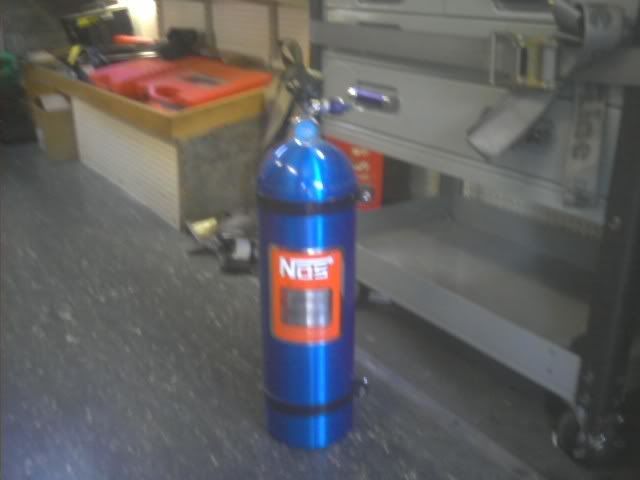

Well a while back (like almost a year ago) I got a nitrous set-up for my 1st gen. Figured that with the crazy EGT's and gobs of extra smoke I'm getting from the 6x16's, its a good time to get everything hooked up!
Went ahead and mounted it behind my seat, this keeps it out of site of prying eyes and fingers. Also I can reach behind the seat while driving and turn it on for those little spur of the moment thrashings.

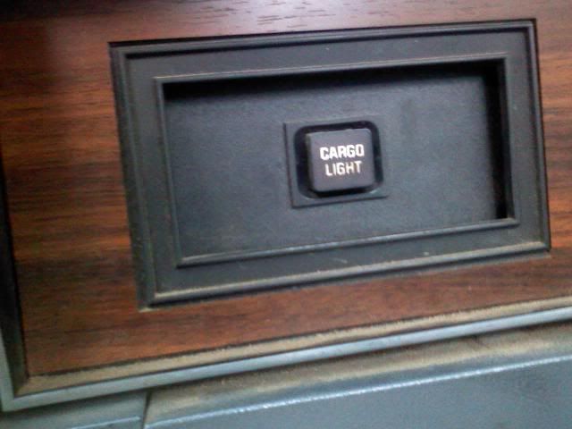

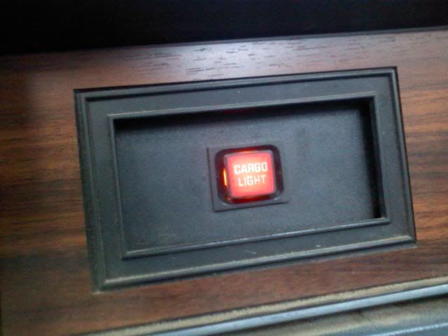

Going to use the Cargo Light switch to arm the system, It wont be obvous... Seeing a pattern yet?
Off
On

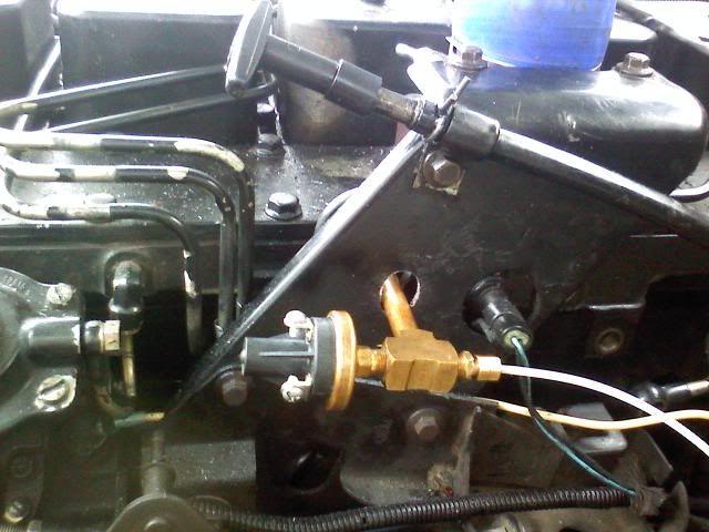

The wire to activate the solenoid has to go threw this 15psi Hobbs switch first, This will allow me to arm the system and it will come on when I hit 15psi.
For now all the under hood stuff is out in the open, this will change when I get either an air to air or air to water. I'll run the braided line threw some heater hose to disguise it and hid the nozzle underneath.
