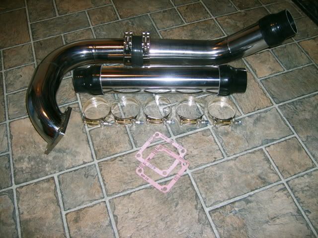

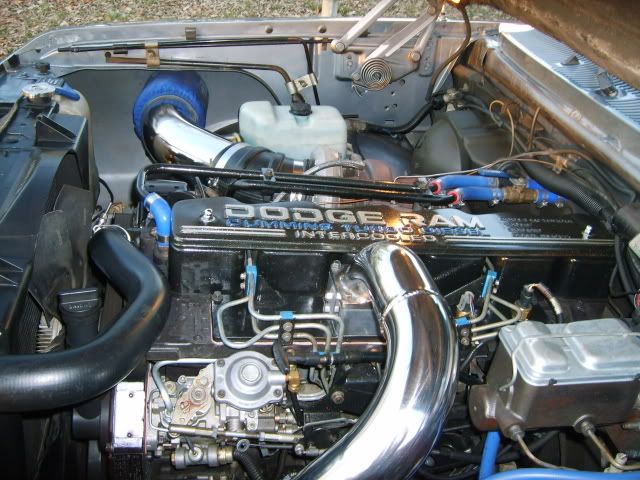

Postby peobryant » Sat Aug 15, 2009 2:24 pm
Lower EGT's, less restriction, and it looks DAMN good. 8)

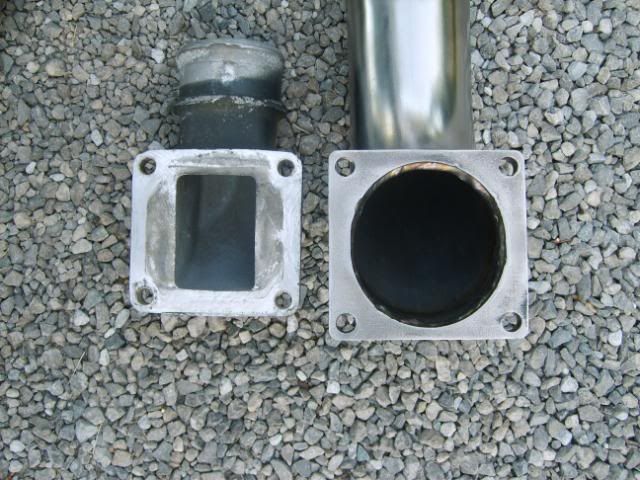

Postby peobryant » Sat Aug 15, 2009 6:14 pm
TTipswprd wrote:they do look good but i prefer function over fancy :lol:
The last picture I posted is the stock 1st Gen airhorn (left) versus the Coolertubz. Which one would you rather have? ;)
I believe it was Philip that said a 24 Valve airhorn will get you the same EGT reduction as a set of Coolertubz.
You could always PM TWorline on here. He is the guy who makes and sells Coolertubz, and he'll be happy to answer all your questions. 8)
Postby TTipswprd » Sat Aug 15, 2009 6:33 pm
oh i see that comparison should have much more air flow with the cooler tubz. ill message him thanks for all the help!
