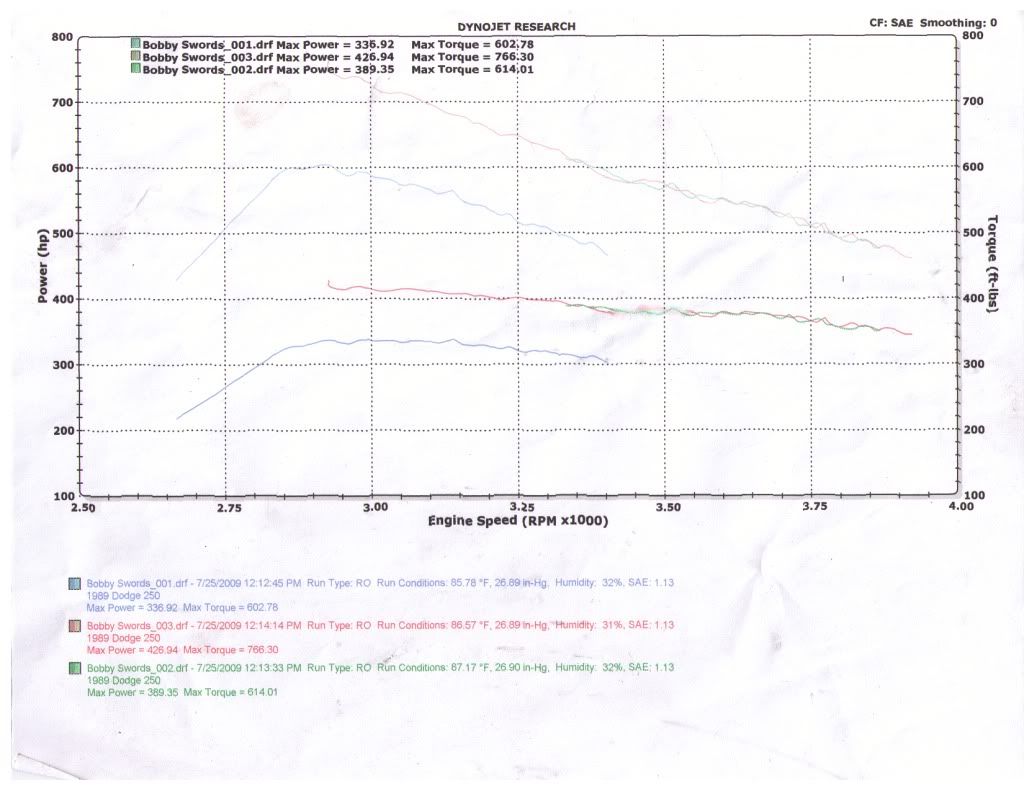

Postby RSWORDS » Tue Sep 01, 2009 2:41 pm
Oh and if it helps here is the video of the dyno run on Daves dyno. 1st run was fuel only. Last two were with nitrous.
http://www.youtube.com/watch?v=M6XPr6Oy-4U
And here is the graph. Is it me or does it look like Mike started teh pull way high in teh RPM's. Could that hurt my numbers on paper because we make all the power down low? These are corrected numbers.

Postby dpuckett » Tue Sep 01, 2009 5:58 pm
What kind of convertor do you have? Stock or aftermarket? Count on a stock convertor robbing 30-40% of available power, i.e. if you make 500hp at the engine, you will only get 300-350 to the wheels with the stock convertor.
I'm thinking the 62/74 may be hurting your bottom end spool. From what I've read, they are more for higher RPM P-pumped outfits. Might step down to a 62/65? Anyone else have a rebuttal?
AFC- what kind of pin are you running? Have you tried a governor assembly from a later pump? Talking to Terry Blue, he said they changed the governor when they went intercooled- cut bottom end fuel to meet EPA regs.
Good luck getting it figured out. Not sure how much help I was.......

Postby bgilbert » Wed Sep 02, 2009 5:13 pm
Sorry Bobby, I don't believe in the non-lockup tranny in our trucks. IMO, even if you had the best 727 money could buy, to put down 500rwhp you'd probly have to be making 650hp. We know that's probly not ever gonna happen.
Maybe oldcool90 will remind me exactly what he gained going from nonIC'd 727 to IC'd 727.... Matt?? Seems like a gain of 60hp. Then without any other changes he gained around 100hp going from IC'd 727 to getrag, IIRC. Matt?
IMO it's hard enough to put down 500rwhp in a VE truck, and to do it, it's gonna take a manual tranny. Oh and we're talking fuel only, non-west coast bs HP numbers lol.
As far as turbo, I think you've got a good one, leave it alone.
And yes, hook up the boost referenced fuel pressure. Try to set it at 1/2 to 1. You don't want big fuel pressure when you're only pushing 20psi of boost... or less.
