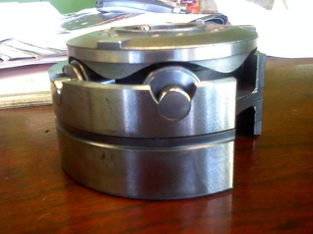

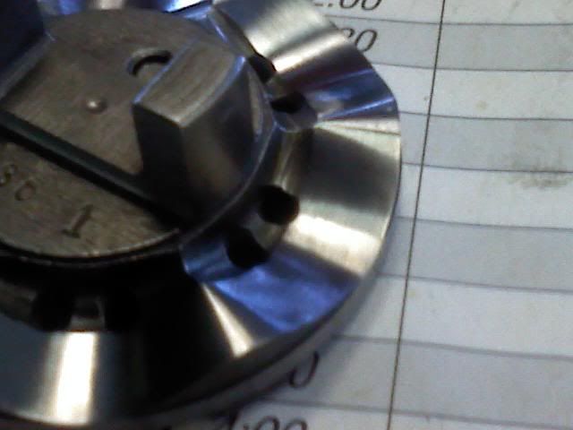

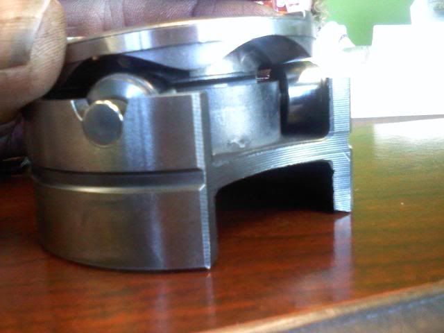

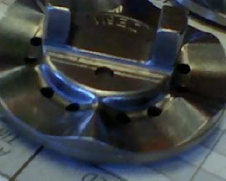

Just received my 4mm camplate from Rockentech, and I have an interference issue. There is a ridge or ledge where the OD of the ears were machined, and it is hitting on the roller support ring ID. It does not let the camplate ride on the rollers at the lowest point of the lobe. Anybody else have this issue?
Called them and explained the problem. They asked to see pictures. I emailed them pictures of the problem. They called me back, and in the best english they could muster told me to GRIND THE LEDGE BY HAND?!?
ON A $400 PART?!?
Here are some pictures so that anyone else ordering from them may know what to expect.
First off a Bosch camplate:
Notice the OD of the ears is smooth all the way down
Next the Rockentech 4mm:
You can see the ledge at the bottom of the "ears" that runs all the way around.
And a couple of pictures of how it fits:
Well after their response, I took the parts to my favorite machine shop(not cheap, but VERY good), and am waiting to see what it will cost me to fix.

The machine shop will fix it, they will just pickup the OD of the "ears" and cut that ledge farther in for clearance.

I would be carful it looks like on your original plate those little ridges on the inside that devide the holes looke like they are pretty tall, if you pick up the OD and turn it to deep you might screw thing up, i would only go as deep as i hade to plus maybe .010 for insurance.
Postby dragrdan » Sun Nov 08, 2009 4:13 pm
The machine shop that is handling it is used to dealing in tighter tolerances than needed for this, so I trust their judgement(prolly why they cost what they do :lol: ). They have the whole assembly as pictured and will do what is needed to get it working.

Postby dragrdan » Tue Nov 10, 2009 11:16 am
Well the machine shop just got in touch with me, they ended up chamfering the ID of the roller support ring for clearance, and found that the area in between the ears is too high and giving the same problem.
As pictured(roller support, rollers and camplate) it sits together fine now, but introduce the input shaft, and the "cross" and it doesn't.
So they are gonna fix that problem.
