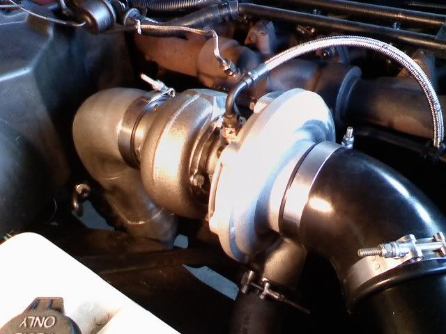

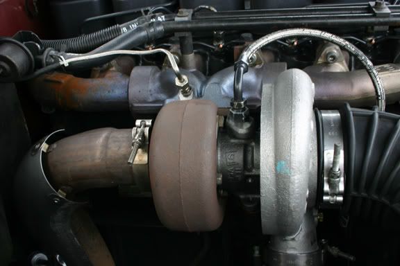

Postby SNOOT » Wed Dec 16, 2009 1:52 pm
Stock D/P
4" D/P and 62 turbo
1993 W350
