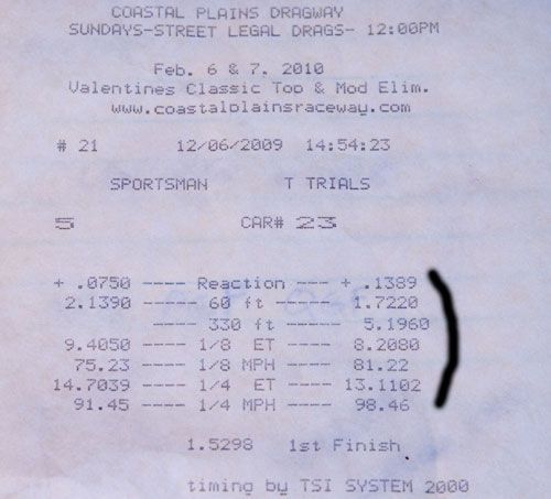

Let me show you what warm and cool air do for my heap at the 1/4 mile track . . ..
At 70*F:
And at 50*F:
These two passes are at the same track, a week in between. Nothing was changed on the truck.
- Notice with the warmer 70* air (thinner air), I got a good 1/4 mile ET and trap speed.
- Notice though with the cooler air (thicker air), the 1/8 mile was notably improved but the 1/4 ET and speed was much slower.
I think the warmer, thinner air let the truck aerodynamically move faster. The cool, thicker air made more power (as shown by the 1/8 mile data), but slowed the truck in the 1/4. I never got the truck above 100mph that day.
