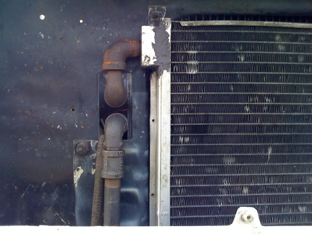

Postby Tacoclaw » Wed Jan 12, 2011 4:27 pm
I've got an air to water IC on my truck, but I still haven't gotten any water going through it yet. (Other projects)
I found a thread that has a lot of good info, but I hope you're not afraid of any imports. :lol:
http://www.iwsti.com/forums/water-meth- ... build.html
Here's a few pics of my setup, though it's been quite a while since I've taken any.
Here's my heat exchanger, it's an AC condensor out of a 95ish Chevy 1 ton with the sick.5 turbo. The blocks are ziptied/JB welded on for testing(that I haven't done), since the current condensor had a pinhole from an accident. A new one with welded blocks will be bought when I see it works correctly:
The general layout. Plan is to go from a very small reservoir to the pump, then the IC, then to the transmission heat exchanger which I don't need with the 'Rag, to the AC condensor, then back to another port on the reservoir:
My revervoir is just an old power steering reservoir from a Mack truck, with the top cut off and a radiator cap welded in it's place. I really just plan to use it to bleed air, but depending on how it works I may need something more.
I'll update my thread some more when I get time, with better pics, but the poor Dodge ain't geting much love this time of year. :cry:
