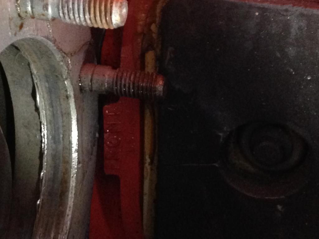

Postby ellis93 » Tue Oct 28, 2014 9:54 am
It's like it grew.....look for the yellow,that's not suppose to show. It's completely pushed out of the front edge of the cover. I just don't understand how that happens.
Also I think I'll be cutting and turning the down draft tube 90 upward till I get the ag valve cover installed. Bad idea?

Postby KTA » Tue Oct 28, 2014 4:04 pm
if you have much blowby at all it is pretty easy to blow that tappet gasket out. I always clean them up with brake kleen and super glue them to the cover. Seems to help, so does screwing one of those K&N oil filler breathers in your oil filler pipe. Another vent is way better than pulling the pump to put that gasket back in.
