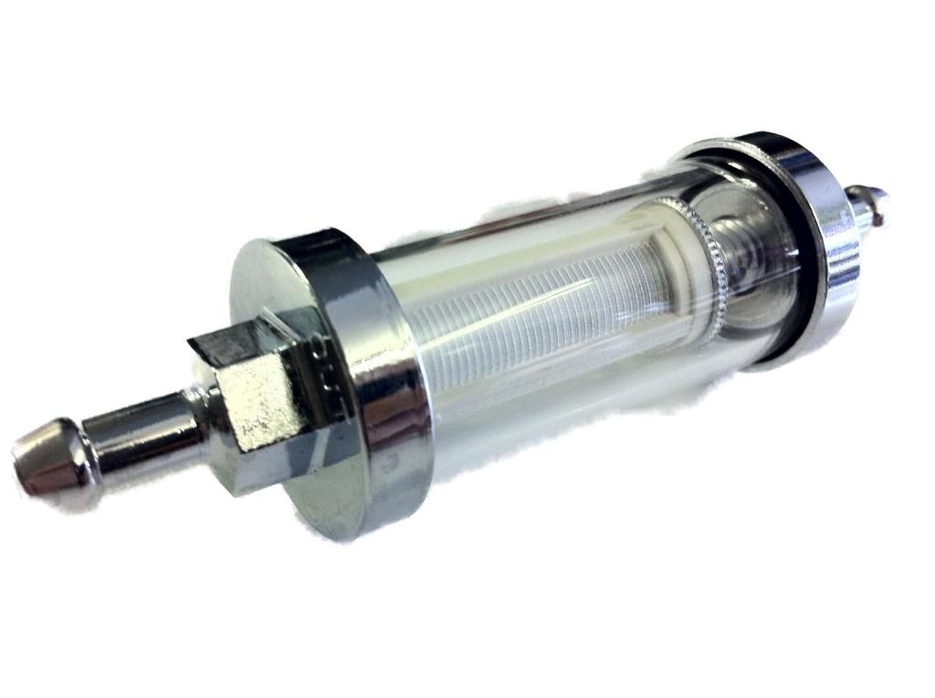

The fuel/water separator was the problem. It now holds 40lbs while I'm calling on the fuel hard. My idle fuel pressure still isn't any better tho. Looks like I'll be doing the regular thing that KTA suggested in the metal part of the return line. Anybody want to buy a tork tec overflow valve :roll:
How I deleted my fuel/water separator is I had one of these
It has a very fine screen in it that should be able to keep crap out of my supply pump but the in and out ports were tiny. I knew it would slow the flow of fuel if I left it like that. So I drilled out both ports and the holes in the cross tube inside to as large of a diameter as I could get before weakening the assembly. Didn't want it to fall apart when tightening it up.
We'll see how this does once I get the regulator rigged up. Hopefully it works out.
