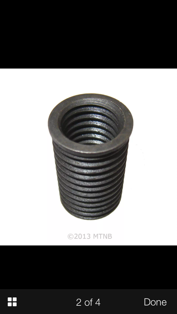

Went ahead and bought these.
20$ worth of time sert threaded inserts to use as adapters. I also will be removing the 24v from its original truck in the next week or so to be mounted to an engine stand,converted over to a ve pump,ran and cleaned of its electrical parts/stuff I do not need. Might even give it a shot of chevy orange for good measure too :lol:
