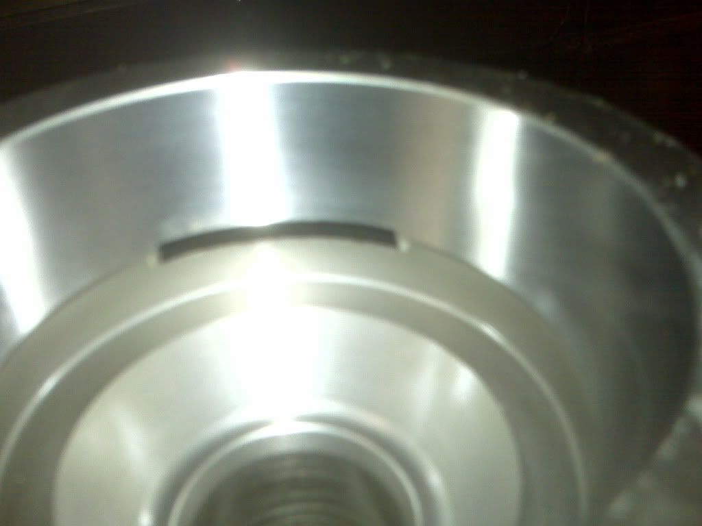

Ok I was talking to Mr Mark the other night, inquiring about a used input before I bought a china unit. In our conversation he brought up the idea of enlarging the lube orifice for the pocket bearing,which I thought was a grand idea. As I've tore into and rebuilt my rag I've thought about doing something a little more radical.

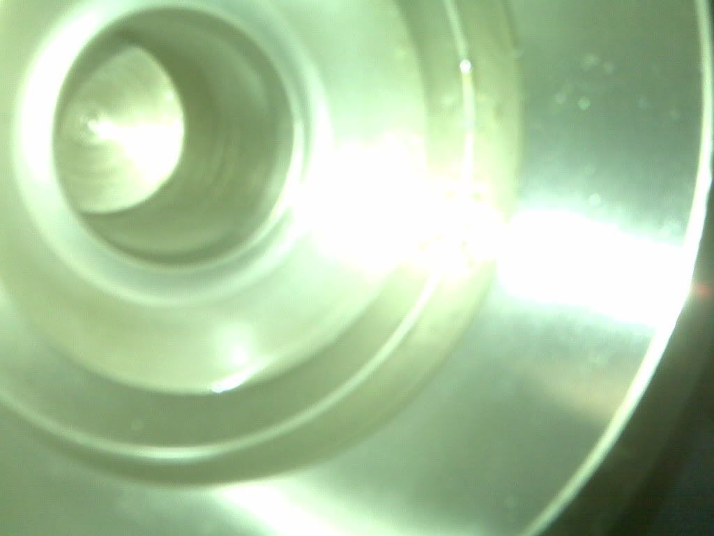

If you look here,you'll see a fairly tiny slot,ONE slot for lube to reach that horrid pocket bearing. I'm GOING to at least open it up on the inside to match the outside machining grove
Inside pic
Ok here's my thought,if ya'll think its crazy say so.
I want to turn the input 180 degreas and cut another slot in it.
Only possible down fall I can see is maybe weakening it for fourth gear,seeing as fourth is direct.
Any thoughts? ;)

Postby ahale2772 » Thu Feb 16, 2012 7:09 pm
I think its a grand Idea
Re: Getrag Input Modification
Postby CumminsPower59 » Thu Feb 16, 2012 7:13 pm
I would say go on the second opening, since it's going to be 180 degrees from the orginal, and if its going to be the same size, I don't see why that would be an issue. From the looks of it, there shouldn't be any structural issues with doing so, I believe only good can come from it with more lube going to the pocket bearing ;)

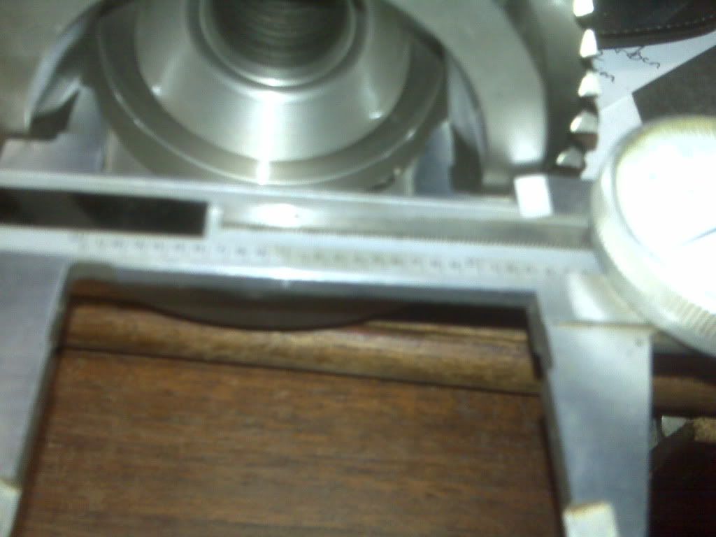

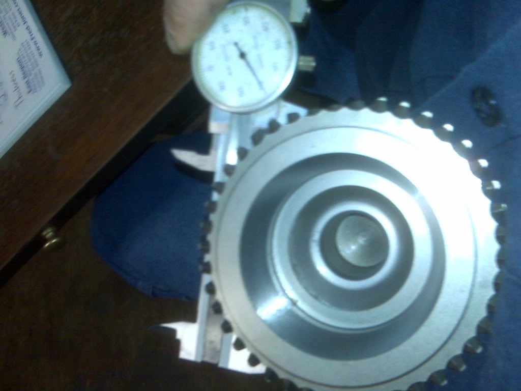

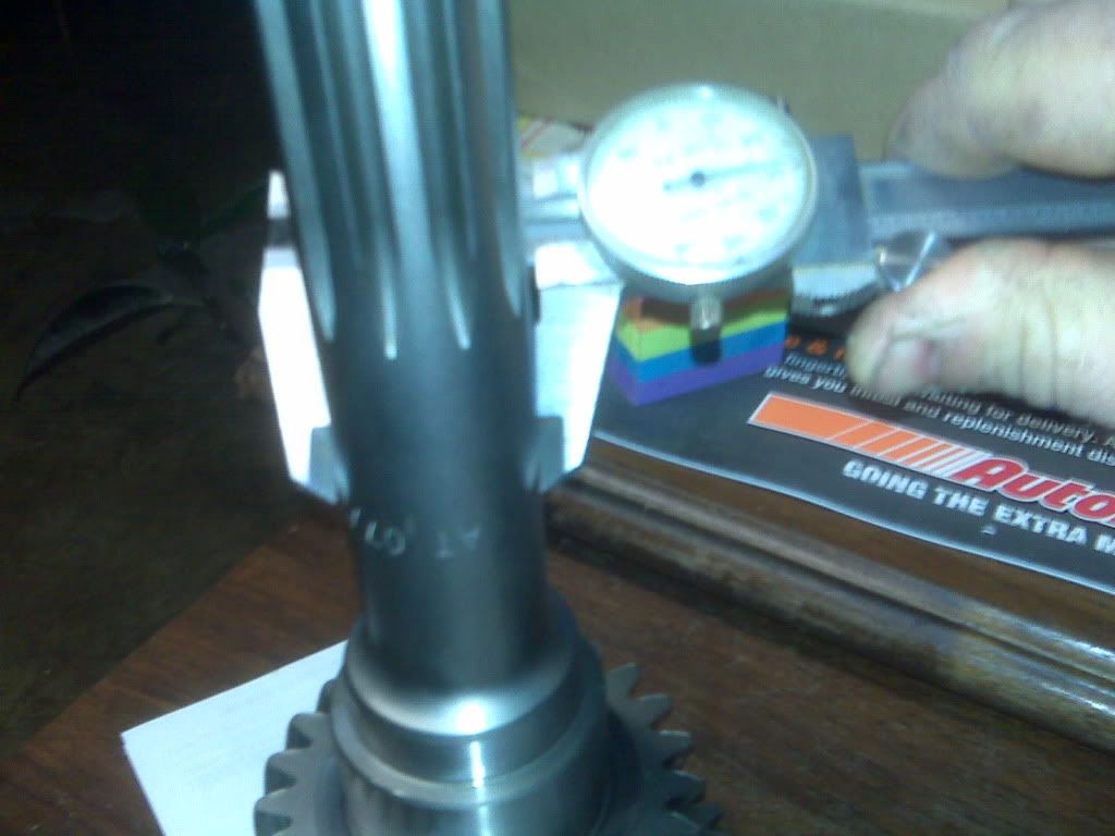

Postby ellis93 » Fri Feb 17, 2012 6:14 am
Alex, the shaft diameter is 1.230,measured here:
The outer diameter of the surface were the slot is, is 2.770. Measured here:
Inner measurement is 2.275 measured here:
