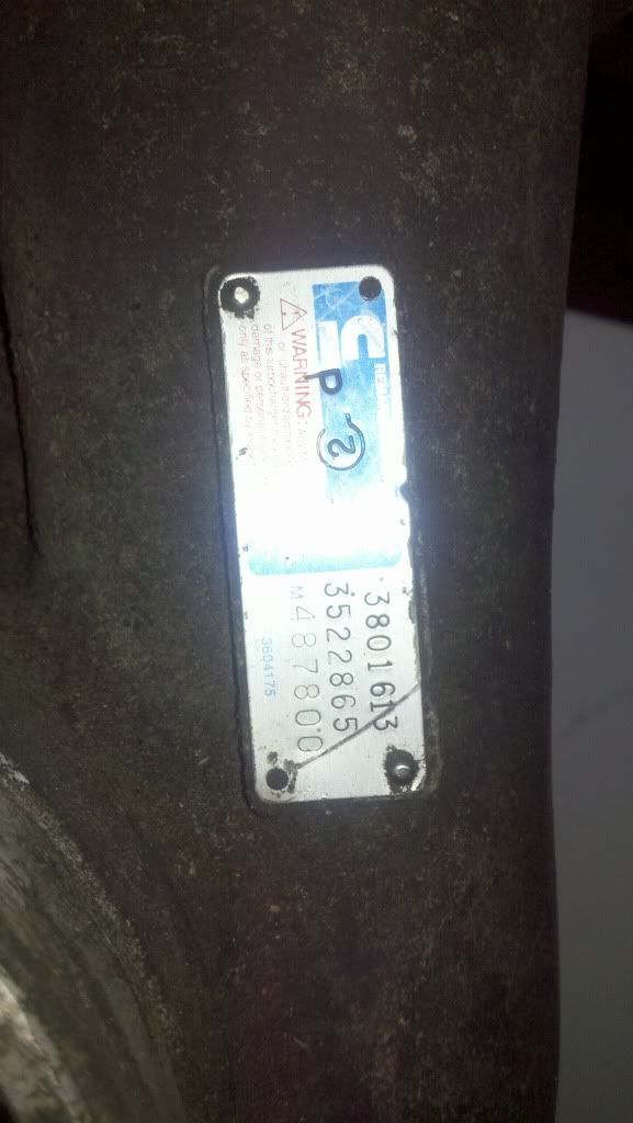

I can't help you on the exhaust housings. A picture may help more experienced people though. After you see a few, you can just tell.
As far as primaries go, I'd bet that turbo from an N14 would be good. The HT3B that's so popular is off an 855, so that turbo is likely a close cousin. 20-22+ cm^2 seems to be the tightest housings for primaries that work. No need to reinvent the wheel, see what works for other people and copy ;)

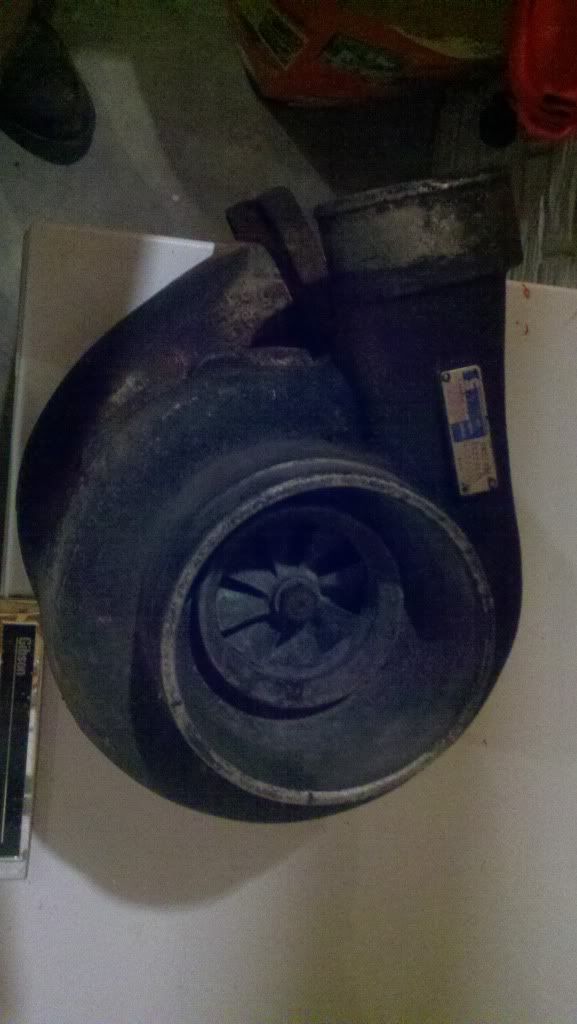

I'm hoping someone can id this as useful or not

Anything with an HX35 is going to spool pretty decently. Your engine will still run off the spooled HX's air even if the primary hasn't come into play yet, so a twin set with an HX won't be that lazy regardless. You might not have 400 horse on tap, but you'll have ~220 or so just slightly slower than a normal HX truck.
The HX35 has a 12cm housing, not an 18cm. It's also typically wastegated, which you'll kinda need for a twin setup. Drill out the wastegate port as big as you dare that the flapper will still cover and take it into both runners of the housing. That will help you out on adjusting your setup regardless of what primary you choose.
