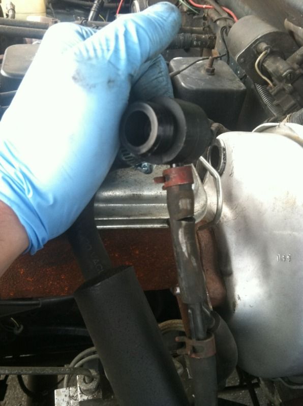

Postby slow_90firebird » Mon Mar 18, 2013 11:13 am
Found the leak!
Thanks! I can't believe that's all it was. When I tested the vac pump though it put out 29-30" so I'm guessing that's good...
Only downside was I broke the plastic barb off the vac sensor... Now I gotta find a way to fix that

Postby slow_90firebird » Mon Mar 18, 2013 1:04 pm
Ya I know and the worst part was that I looked at everything else first... Finally I pulled the check valve out of the booster and saw that right away!
I was just worried because this morning I had essentially no power brakes at all and tonight were supposed to get a snow storm. Didn't wanna drive to work tomorrow like that and my car hates the snow...
