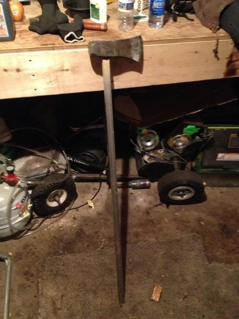

Ye. Once I got to the point of beating it with a smaller hammer I knew that wasn't the best so I had to work with what I got in a rented garage at school which was an axe head with a sledge on the back welded to a piece of square stock and tapped it with that and it didn't do anything I'm gonna try doing what u said and put some pressure on it with that bolt. I did try that befor but didn't try hitting it at the same time. Ill see what happens and thanks for the input.
