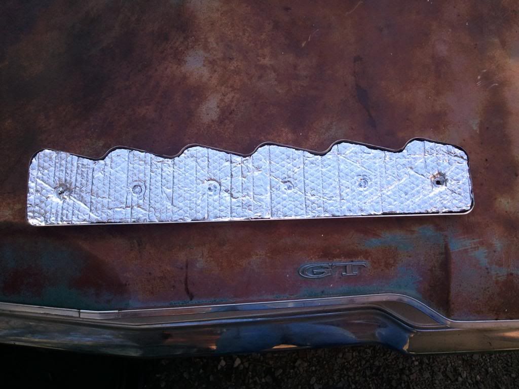

I noticed that if I put my hand on the valve cover plate the engine was significantly quieter, so I traced the plate on some sound deadener and cut it out, then glued it to the backside as pictured. It made a difference.

It was probably rattling because the rubbers were beat. A washer under each end may have done the same thing. ;)

It actually wasn't rattling, but it was transmitting noise.

PToombs wrote:It was probably rattling because the rubbers were beat. A washer under each end may have done the same thing. ;)
Seems I tried the washer thing and the vibration had the washers cut into the plate. Rubber washers between the steel washers and plate are a must I think.
Your insulation trick is still neat. 8)
