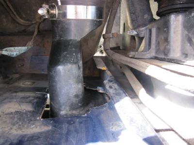

Forgive me guys I'm still learnin' how to post pics. comotionman did you use a rad support from a later 1st gen along with the grill? I heard those psic's are really thick. Anyway thanks cmann250 for the link to the DTR post I referenced. I had to ditch my AC condenser so the IC would fit behind the center grill (still had to break out the dremel to shave down the plastic). I didn't have lower support brackets for the IC so I just fabbed up some with a small sheet of 1/16" aluminum I had. Here's the IC outlet:
I had to grind the battery tray corner for the pipe to make its way to the intake.

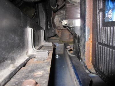

Here's the IC inlet:
I had to bash the inner fender well a bit with a small sledge to get the pipe to fit up.
